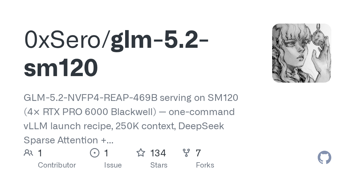

There is someone, 0xSero, who is championing open source LLMs, and right now is working on using Cerebras REAP frame work to prune experts from MOE models to reduce the memory footprint with minimal impact to performance. The experts that get pruned depends on how you set up the prune.
0xSero has pruned DeepSeek v4 flash for coding in the past, and I was going to do the same. However I ran into his Huggingface last night and saw he has also pruned GLM 5.2 for coding!
The claims are that GLM 5.2 are Opus 4.8 level intelligence, but I have never run it because it is enormous, and won’t fit on my system. However, now that it has been pruned and quantized all the way down to 4, 3, and 2 bit, it is possible.
Now, it’s still big, the 4 bit (both GGUF and NVFP4) is still large, over 300 gb of VRAM, but I can now fit it on my hardware and I am going to try it out this weekend. Frankly, this is amazing.
Anyway I just wanted to come here and share that for anyone else who is running locally. If you don’t have the hardware to run it, I would still be excited because what I think this is starting to show is that we are going to get some crazy good local options in the future for much less VRAM. The future is looking very interesting.
By the way, REAP is on GitHub and you can prune models yourself, as long as they are MOE, so you could take something that doesn’t fit on your hardware today and make it work for your use case.

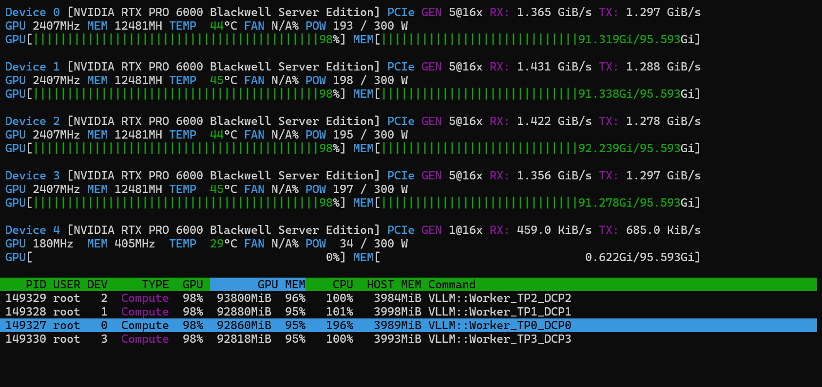

This is legit bananas, glm 5.2 on a 4x rtx 6000 machine

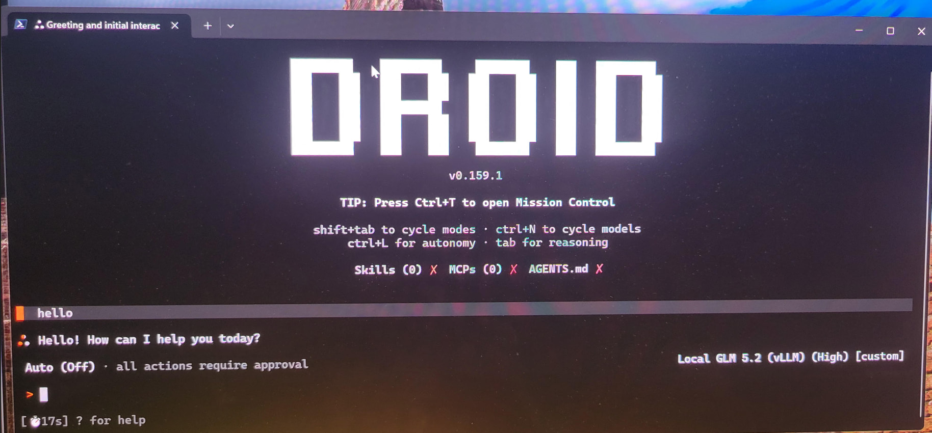

I’ll report back once I get GLM running on my server. According to 0xSero’s posts, it held it’s coding and reasoning intelligence.

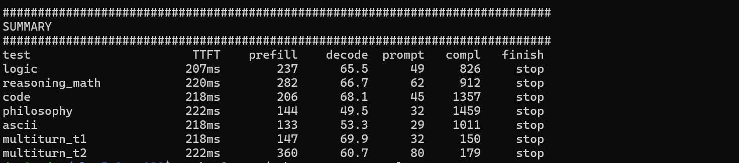

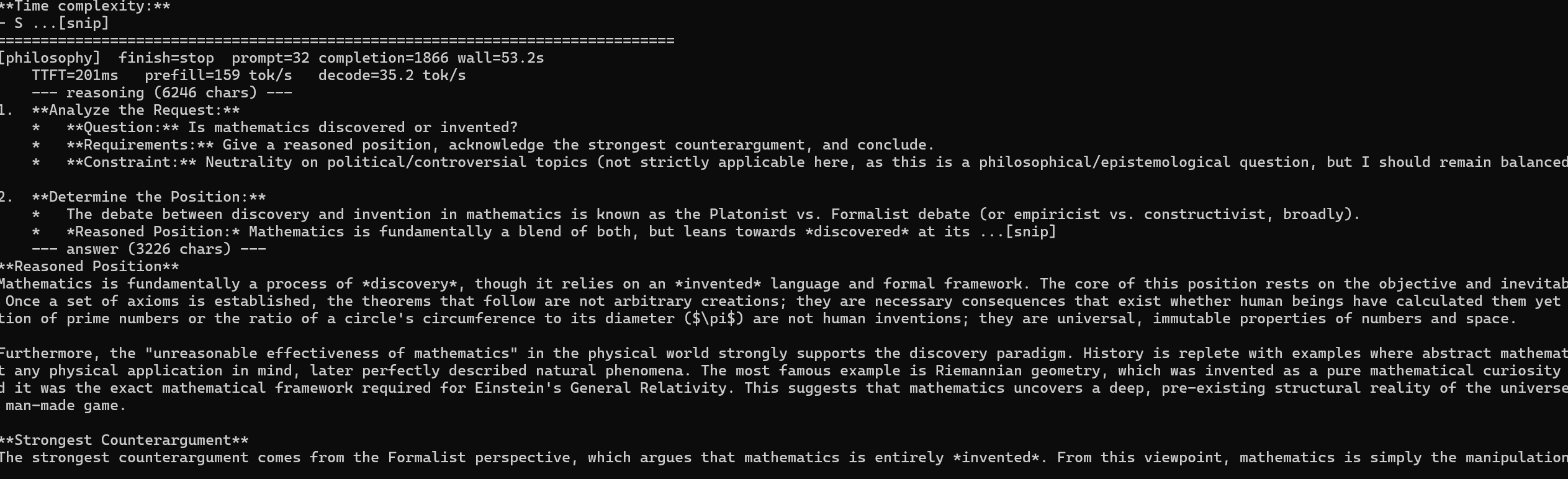

Running tests now. I haven’t gotten MTP working yet but so far so good.. Only 35 ish tokens/sec so far though..
Ok with MTP on I am getting the following. I think this is as good as it gets.

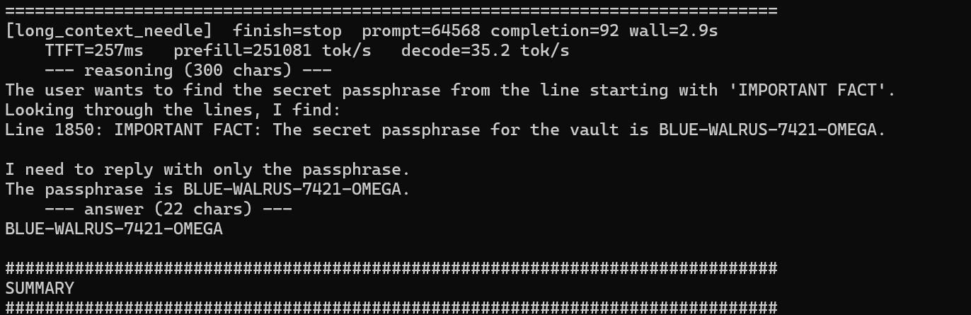

I wish this were just a touch faster with the full context

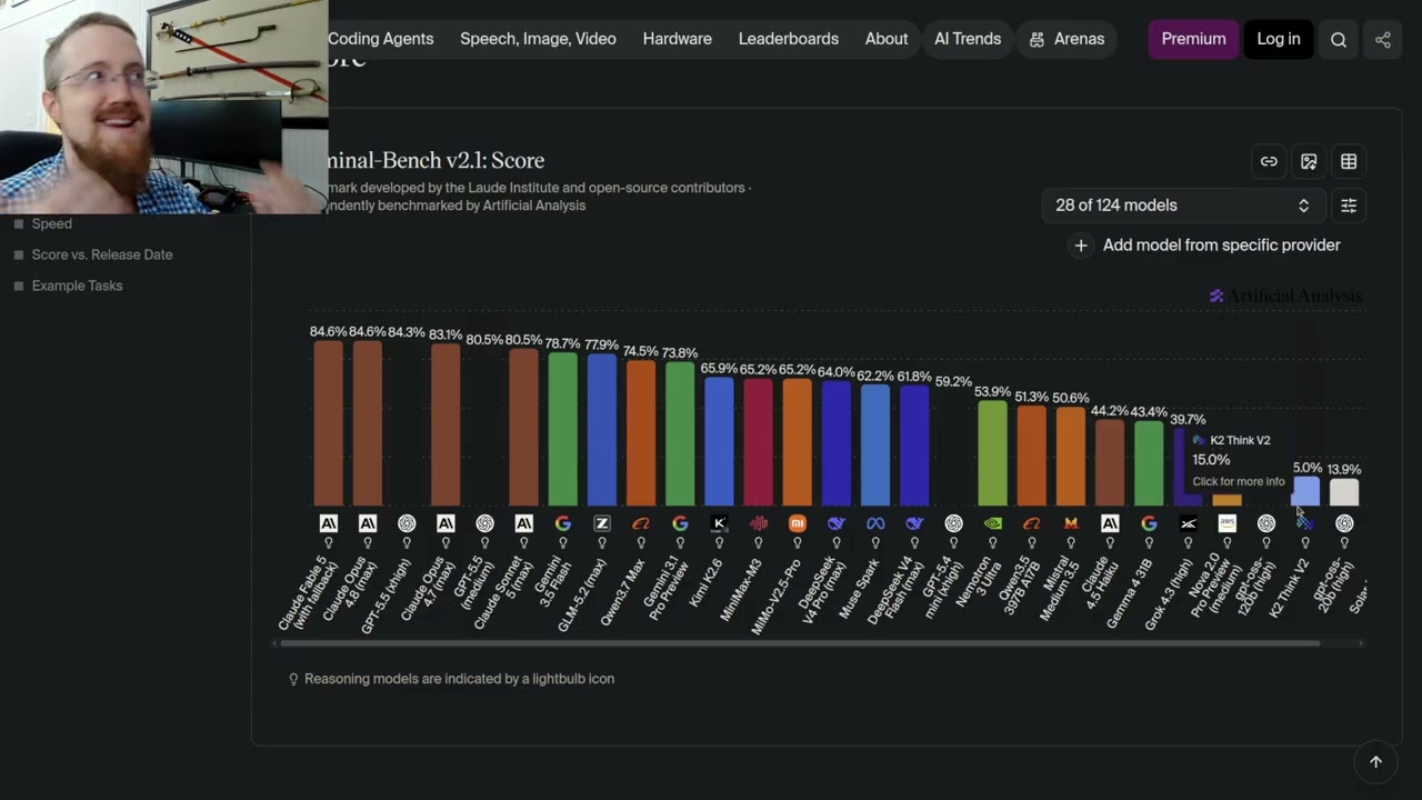

surprisingly deepseek v4 flash was the fastest for him while still near the performance of a compressed glm 5.2 model
video just covers the article + his rambling about how large models seem to degrade when trying to compress them.
Also relevant for thread, he says that reap lobotomizes the model for tasks other than coding

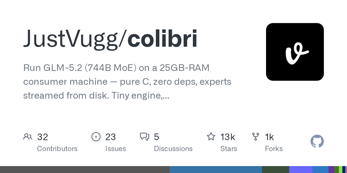

Perhaps tangentially related, just came across this:
Looks like it’s not reap. Runs on 6x 5090’s.
