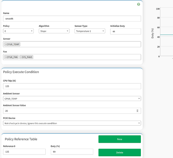

HI, i just got the ME03-CE0 with EPYC 8224P. The NOCTUA fan drove me crazy to start oscilating. After many attempts setting them via Lan login to MegaRAC, it seemed some changes where no taking. So after plugging in the LAN Mgmt cable, and login in, seems like I now had write permission in default setting. I set it per this picture at 44% and now its not oscillating any more.
I did the same (but only 40%) which stopped the random on/off cycle. But I’ve still had my fans hard lock at 100% a couple of times overnight.
