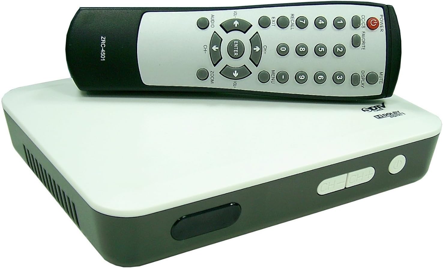

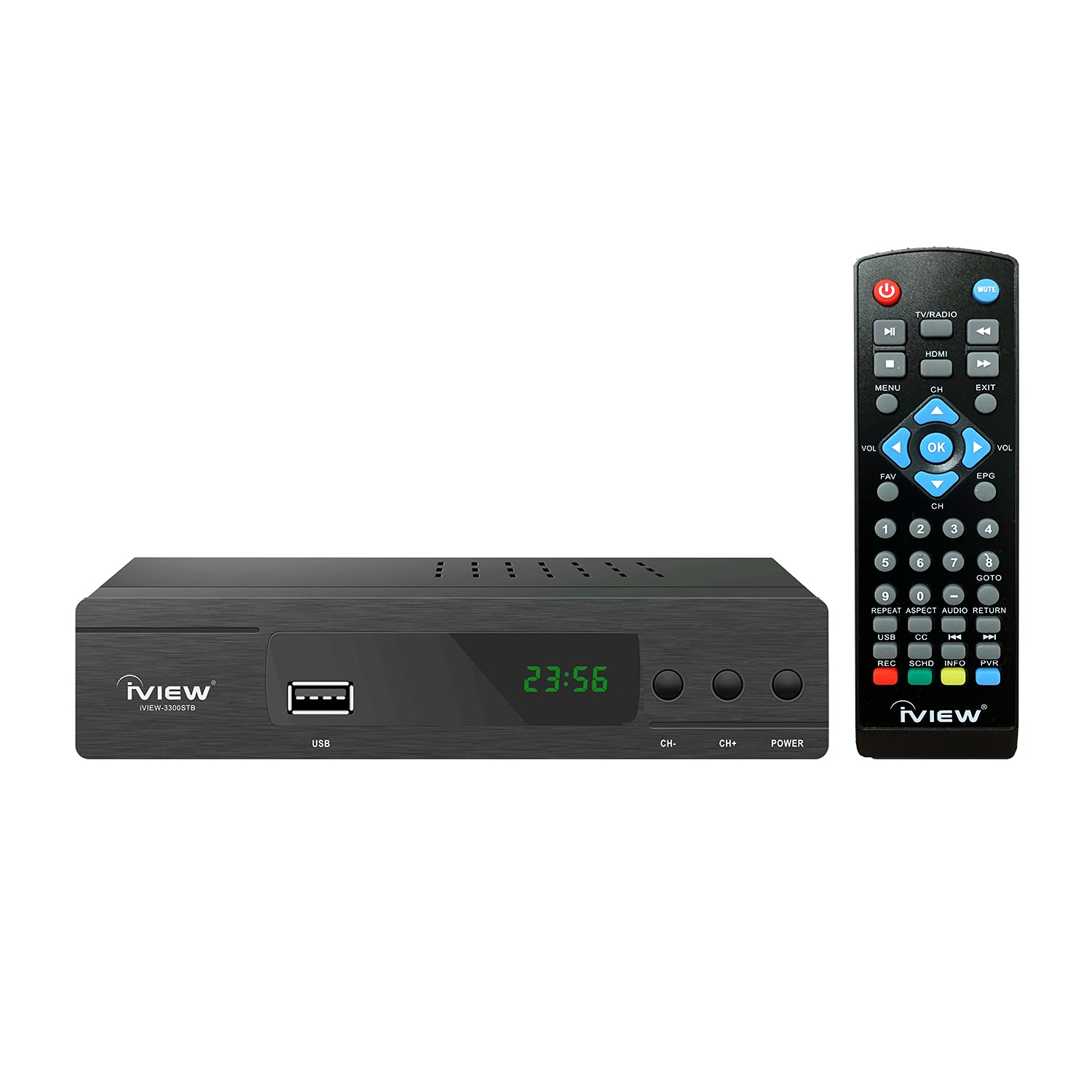

I have THIS
Actually I have 2 of these. What I would like to do is set up a giant antenna on our roof or by the guy next door’s radio tower, actually finish hooking up the coax all over the house. plug the antenna in, and have 1 box on top of his computer, whatever the fuck one it might end up being, and the other one I had other ideas for.
