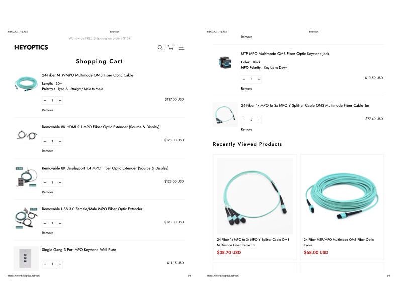

https://www.heyoptics.net/
USB and Display over fiber
this looks like exactly what i want if it works how im thinking do you have experience with them? could advise if set up would work
This is the set up i believe i want if anyone knows more. If i made any errors to this in my thinking or if it looks good. Please let me know. Thanks for all the help so far!
Yeah I have the HDMI one for my TV in the basement
Reach out to their support they are pretty quick to respond
They do not add perceptible latency if the decoder on the client is good. 1-3 ms if i recall
Could be useful to hold you over if you don’t want to install fiber right away, or if you want some clients on occasion that aren’t connected.

The overall goal is a 3u sliger for wifes machine mine in a 4u and pay for the overprice hl15 to upgrade my storage solution then decide on a 1u/2u compute server
