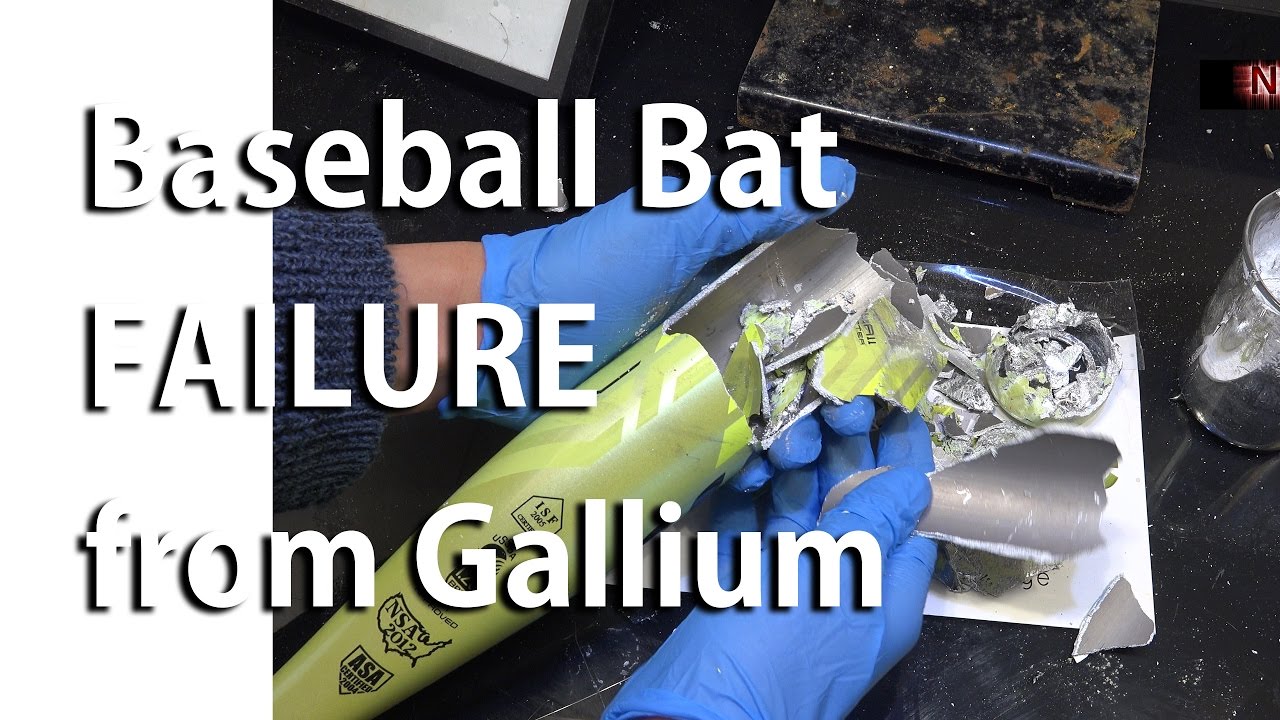

Also mixing Gallium and Aluminum is a very bad idea.

Just YouTube > gallium vs aluminum
