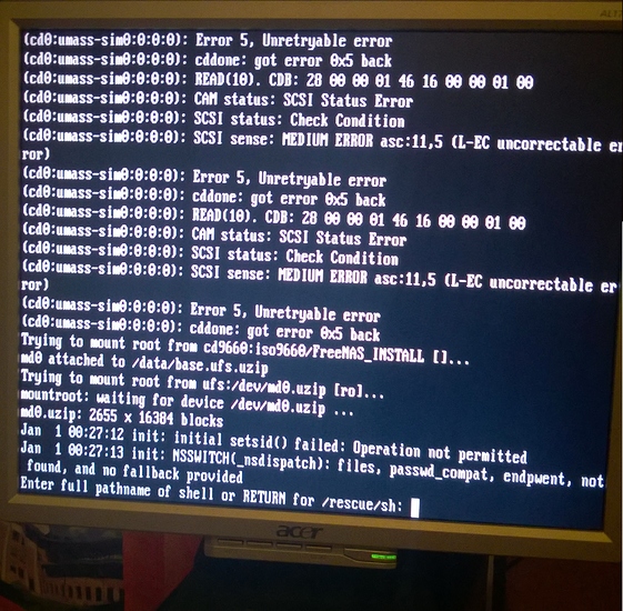

I downloaded FreeNAS 9.2 burned it to as disk and waited. I got to the BSD menu and selected single user [2].
This is wehere it is right now :/
mabye try the CD agian but with an internal CD Drive instead of usb?
I just rebooted the machine with the same disk and it worked, got it running and turned the disk all on, they showed up on the list I guess it worked.
