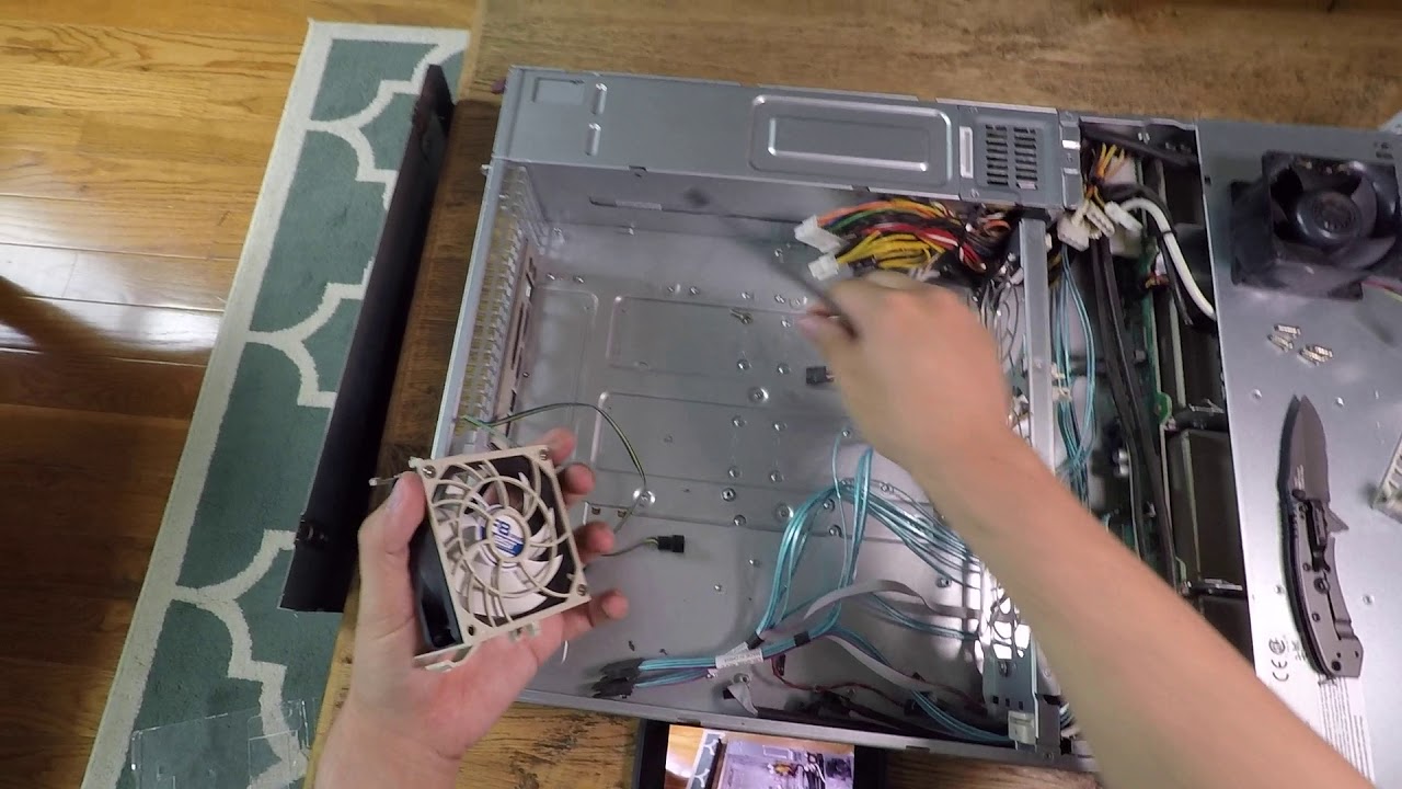

Looks like it has a SAS backplane according appendix A of the chassis manual.
I would definitely confirm 2TB+ drive support. It supports a floppy drive which isnā€™t promisingā€¦
Good news is you can get any old LSI HBA and plug the backplane into it for good FreeNAS support.
I run my vms in another box the freenas box is stand alone for me
Can always swap the backplanes for sata only ones. (doubt the mobo only supports 2tb or less drives its not that old e3 v3
Yeah, the motherboard is surprisingly new for that chassis.
This is the backplane youā€™d probably want, but Iā€™d double check form factor compatibility with that chassis.
https://www.ebay.com/itm/BPN-SAS2-826EL1-Supermicro-2U-12-Bay-SAS-SATA-3-5-HDD-Backplane-for-6027R/182861847291?epid=2254569496&hash=item2a936a5afb:g:n8EAAOSw3G9bkt8Z:rk:2:pf:0
Nevermind, that wonā€™t work. The chassis a for 8 hot swap drives, not 12. Had to make room for that floppy drive I guess.
Thatā€™s a very odd chassis sku. It looks like it was originally made for AMD boards (H8) circa 2010 and then reused for Intel boards about 5 years later (X10). That explains the floppy drives and first-gen SAS backplane. I wonder if they needed to burn extra units because of low AMD demand.
https://www.supermicro.com/products/chassis/2U/825/SC825TQ-563LPB
Iā€™ve had my eye on one of these. Probably overkill in your case, but I donā€™t think you could find a lower price for 45 bays. The only thing I am unsure of is 2TB+ support in the SansDigital AC-SAN-5PMBP/SYBA SY-PEX40008.
Also, itā€™s only SATAII, no SAS.
Oh, the RAID cards only support up to 1TB drives. You could probably swap them out for something else though.
