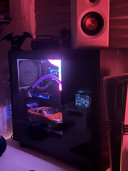

Hi! I had a Node 804 a couple of years ago and it’s been ok-ish for the most part but it’s showing his age when it comes to cable management and material choice. Especially for the price i would not recommend it. I switched to a define 7 (which also exist in mini,compact and XL) and its bigger but the node is not that small either. Its just not that tall but has a big footprint and the acrylic side panel scratches the moment you take the peel of.
