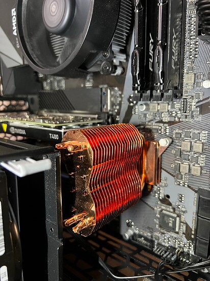

Also I changed the passive cooler for the chipset (x570) for Primecooler PC-NBHP1 because it was the hottest part of the system after few days of test run.
