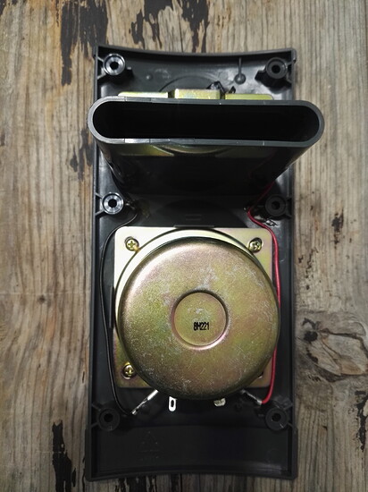

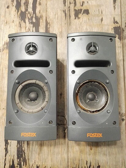

I’m looking to replace or rebuild two 3" woofers.
I looked up the number on the back of the speaker (8h221), but no relevant results.

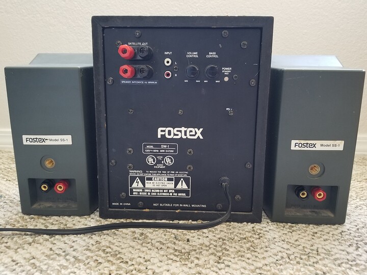

This is the complete system.

Anyway, the cones appear unbent, so you have a good chance at restoring them, if you know how. I wish I could help further, but I don’t know how to repair speakers. Perhaps one day. Let us know how you get along!
I was thinking about taking the sub apart to see if it would mention the Ohms somewhere in there (like on the amp). I wouldn’t be surprised if the sub has a different Ohm rating from the speakers.

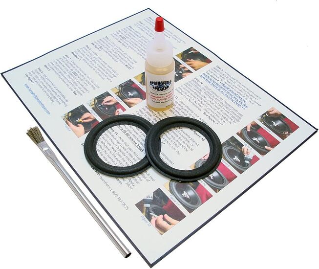

You have a few options on the table. Only one of which gets you stock-ish performance.
1: refoam. Use the pioneer foam and hope for the best. It may or may not work. Not all foam is equal, so its hard to say what success you will have.
2: different drivers. This will change the sound. It is probably your most risky option. You could easily end up with something that sounds out of wack. But there is a small chance it can be better. I would say that even if you knew every single detail and spec of your drivers, there is about a 10% chance you could be successful.
3: Just build new speakers. This sounds crazy, but think about it. The pioneer foam is 23 bucks, new drivers would be closer to 30 bucks.

I should mention this system has a sub as well with an amp built to power all the speakers.
I’ll add a picture of the complete system when I get home.

I’ve got the same speakers, same problem. Not sure if the tweeters are ok or not (will test eventually) but the woofers sounded fried so when I opened up the cases I saw the same thing you’re showing here.
As for refoaming them, man, I dunno. I just finished a refoam job on a pair of vintage JBL L40’s, my first such job, and it was stressful, though ultimately successful. Here, they’re just so small! I have big fingers! I might just replace. The drivers you mention as candidates seem like good choices. I would love to try the Faital 3FE25s, but they seem just a bit too big physically, screw-to-screw, to fit. But the Peerless seem like a good substitute. I’ll let y’all know if I actually get to do this. They’ve been kicking around unused for a few years already, I may have to re-shelve them and finish my Magneplanars before getting back to these!
Oh, I did want to add though, they’re not MDF, they’re some kind of plastic resin case. It’s all one piece molded box, with a separate removable front panel. Zero insulation inside, big copper (?) plate in the bottom for… mass? Not sure. Some of us don’t like to throw stuff like this away; would rather repair than dispose. They seem a pretty good start; I’d hate to see them just end up in the landfill.
