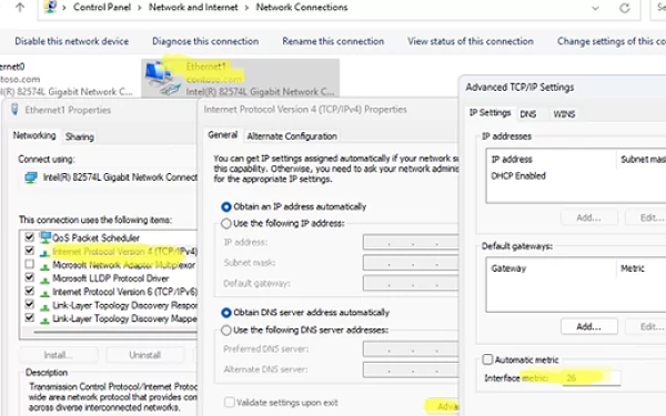

Metric, or interfacemetric is what you want to change, lowering the metric on the 2.5 gig links, for both sides. That or routting/default route
You can also change the priority (metric) of a network interface in the network adapter properties using the Network Connections applet (ncpa.cpl) in the Control Panel.
Open the properties of the IPv4 protocol in the adapter settings → Advanced → change the value in the Interface metric field and apply the changes.
By default, the Automatic metric option is enabled here, which indicates that the network adapter priority is set automatically according to the link speed.
From here. Change Network Connection (Adapter) Priorities in Windows | Windows OS Hub
