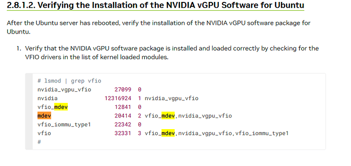

The article I attach relates to vGPU but mentions that there should be a /sys/class/mdev_bus/domain\:bus\:slot.function/mdev_supported_types/ option but for me there is no mdev_bus there either.
It also mentions there should be a /sys/bus/pci/devices/0000:22:00.0/mdev_supported_types/ but it is not there either. It seems like there is nothing at all relating to mdev functionality in Fedora 42 on my computer and it is a pretty fresh install.
I am referencing this article:
does lsmod at least show you’ve got vfio_mdev?
mount | grep sysfs
ls /sys/class/mdev_bus/ maybe?

… ohhhh I read vfio_mdev has been deprecated and is only mdev now.
A sudo modprobe mdev yielded a few new directories …
/sys/kernel/btf/mdev
/sys/kernel/debug/printk/index/mdev
/sys/class/mdev_bus
/sys/bus/mdev
/sys/module/mdev
I think I might need to load the mdev module first and then try again.
Now I have /sys/bus/mdev/devices but it is empty. Strange, but I guess that is more where I have to look.
