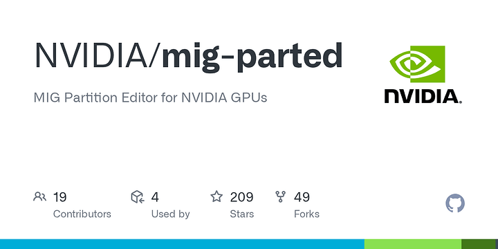

This does not survive reboot. Nvidia does provide a daemon stub that is usable to automate this on boot:
Overall nvidia’s documentation is reasonably good and should also be used as a reference.

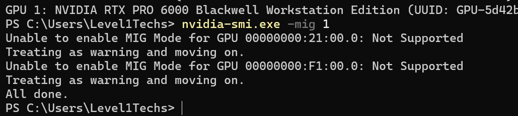

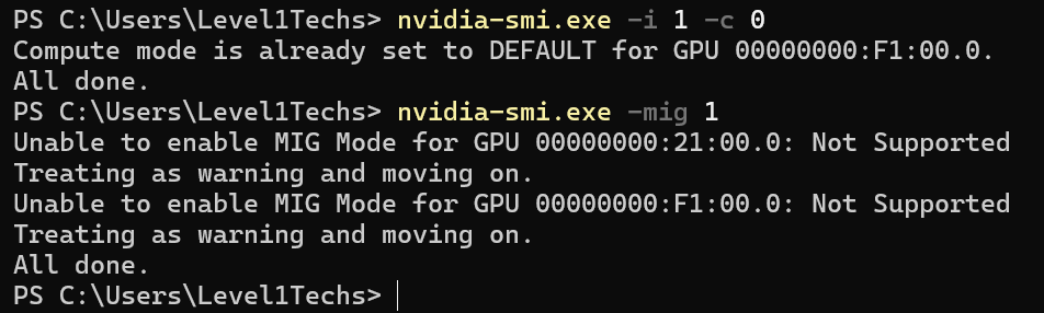

What about windows as a host?
It should be okay since it is okay on the A100 with hyper-v, but it isn’t.
Not supported!? Lies. It is supported elsewhere, but not with this platform. This is yet another instance where there just isn’t feature parity from Nvidia on Windows vs Linux.
And it’s extra baffling given older enterprise GPUs also work here. MIG isn’t that new. Given hyper-v does actually work okay with sr-iov, I thought it might be possible to put the card into the right mode then soft-reset the machine back to windows from linux. However as I said in the video, It doesn’t work for some reason.
