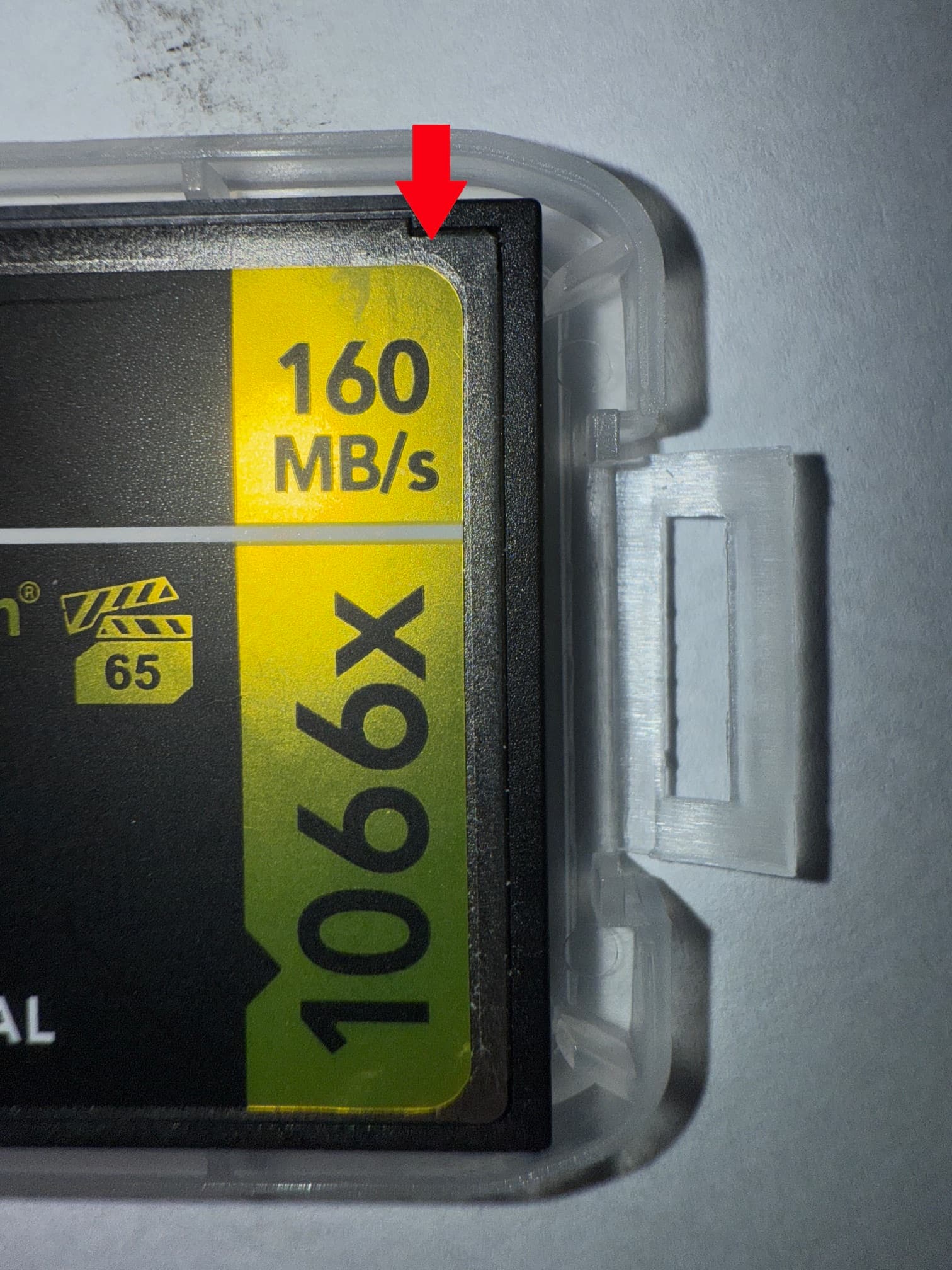

I just bought a “new” Lexar Professional 32GB 1066x Compact Flash (CF) memory card from eBay and I believe its fake. I’m wondering if it could have had any viruses or malware on it.

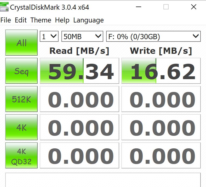

It came in the clear plastic shell and the label looks real. When I plugged it into my computer (Windows 10) and did a speed test its very slow. I did a h2testw_1.4 test and it passed without any errors. Its rated for a max of 160MB/s read and minimum of 65MB/s write but the real speeds are way off. After looking close at the label it looks like there is adhesive from a previous label on the card. The slow speed and label makes me think its a fake CF card.

Lastly, check whether a benchmarking tool can write and read the whole drive’s capacity. If it can, it’s not fake but the specs might be exaggerated, which is also a reason for returning it.
Use a software such as the SD Card Formatter to format the card for maximum performance.

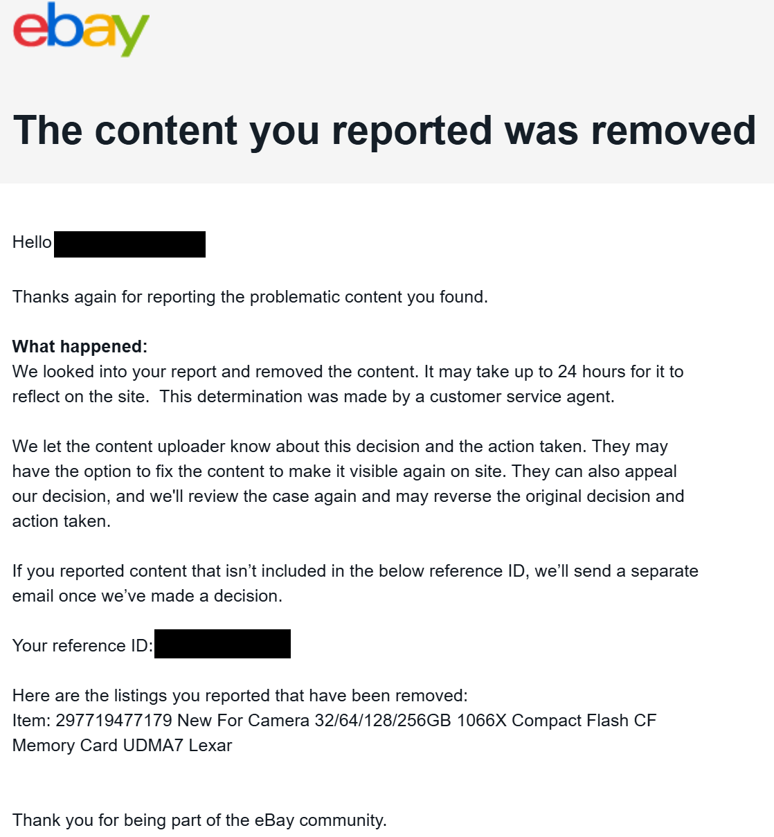

I reached out to eBay about the possible fake CF card and they took down the listing. I’m wondering if eBay punishes the seller by banning them or deleting their accounts. It would be concerning if eBay just gives people a slap on the wrist if they are caught selling fake goods.
