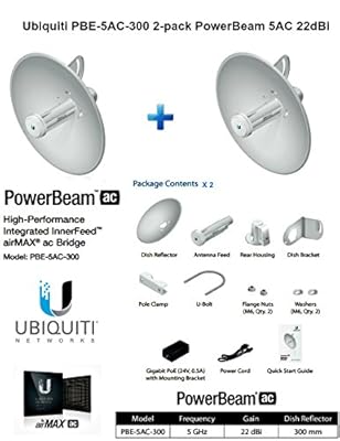

Setup a point-to-point connection with directional access points. Ubiquity has good (and affordable) solutions for this.
I've seen near gigabit speeds on a p2p 802.11ac link (over a distance of 1 km with dish antennas).

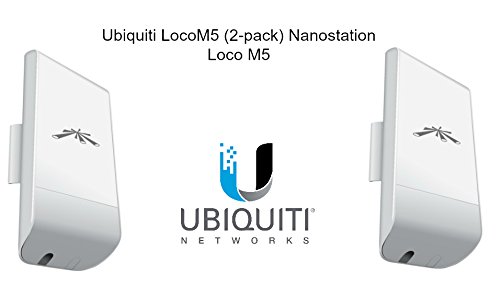

This would work perfectly https://www.ubnt.com/airmax/nanobeam-ac/
If you have trees in the way maybe look at 2.4Ghz instead as it travels through materials better https://www.ubnt.com/airmax/nanostationm/ is currently what I am using to bridge a 100 metre gap and that was complete overkill but would work great. Nanobeams are insane for the distance you want a 2.4 nano station should be more than enough to cover 210 metres.

I have quite a bit of experience with the Ubiquiti equipment. They are definently the way to go for cheap point-to-point wireless bridges. Depending on what your bandwidth requirements are you can pick up a set of them on Amazon for about 100-120 bucks. They are super easy to setup as well. The problem with getting antennas is that you lose signal strength the longer the cable is. The Ubiquitis have the antenna built into the radio.
To note tried lots of things before i went with Ubiquiti, tried repeaters (worked but constantly lost the connection between the two networks (not surprisingly). Did try an yagi antennas but due to where the devices had to be placed meant the aerial was too far away from the antenna and just created a poor connection (worked but was very slow).
So when I went to Ubiquiti thought i might still get some pains. How wrong i was, I just placed it on my window sill and one in the other houses attic and even with this terrible position the bridge worked perfectly (only problem being the bandwidth was quite low). Once I had fitted one on my outside wall I then had a perfect connection, seriously you get what you pay for when bridging networks, literally since I have had them installed I haven't had a single problem. Worth every penny.
This ubuiqiti gear sounds like the way to go. What do you think is the cheapest option? I'll continue researching in the meantime.
I used Ubuiqiti Gear to connect 4 school campus and a whole CCTV system over the neighborhood. So I would say yes, it would be the best option.
Depending on how much bandwidth you need that is the cheapest option. If you need more than 50-80mb than these will be your best option.

Point-to-point wireless is still the most cost effective option for a good connection.
