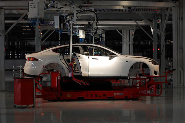

Experts say Tesla has repeated car industry mistakes from the 1980s
As Hamtramck’s assembly line tried to gain speed, the computer-guided dolly wandered off course. The spray-painting robots began spraying each other instead of the cars
When a massive computer-controlled ‘robogate’ welding machine smashed a car body, or a welding machine stopped dead
automation works best when it’s added incrementally to a production process that’s already working smoothly
