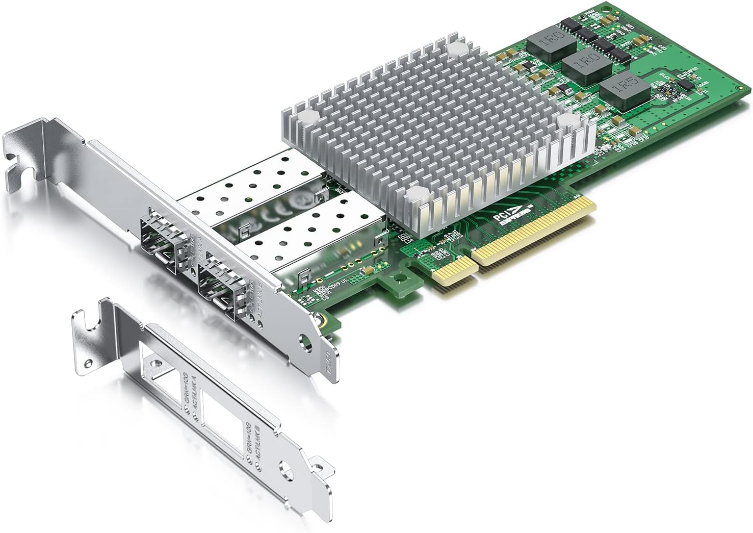

What cards and cables are you looking at getting? Mellanox 10gb CX-3 cards are often about $20-30 on Ebay and used SFP+ cables can also be found there very cheap.
You probably don’t want to get 10GBase-T cards (copper). You’ll find 10G SFP+ cards much cheaper, and only need a twinax cable to connect them together.
As of now, this is the leader. There’s RJ45 and SFP options. I just don’t want to have to replace my switches as well so RJ45 is the cheaper option.

Grabbed two of these. They come with a cable so should work. Decent price as well. Could only order one at a time though. Bit of a PIA. Will report on how they work when installed.
