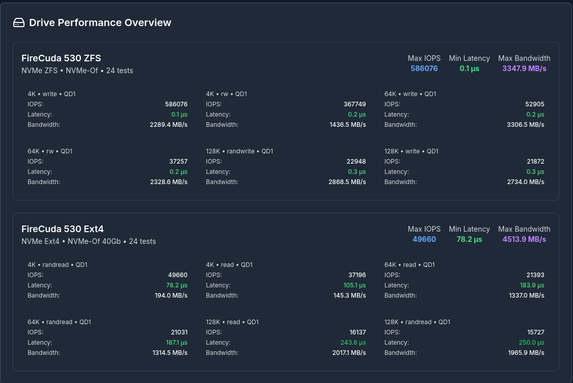

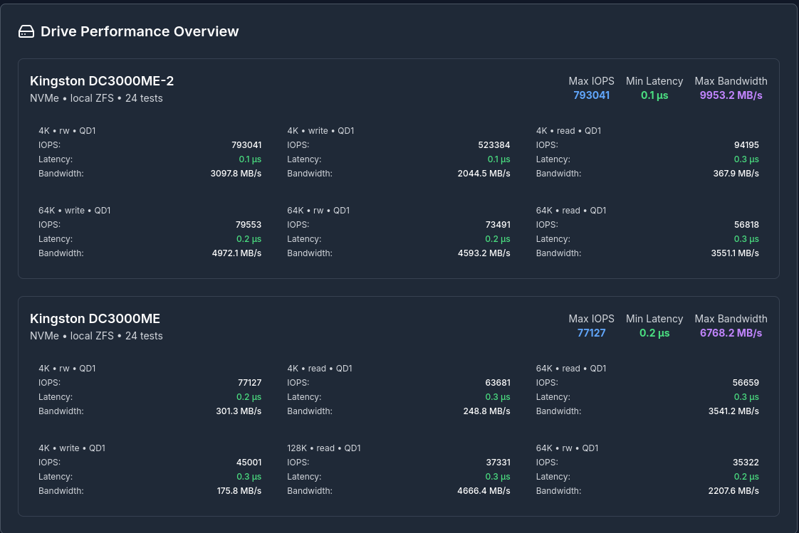

DC3000-ME is with ZFS default settings
For DC3000ME-2 I used this settings
zfs set compression=off             tank04/bench
zfs set primarycache=metadata       tank04/bench
zfs set secondarycache=none         tank04/bench
zfs set logbias=throughput          tank04/bench
zfs set sync=disabled               tank04/bench
zfs set dedup=off                   tank04/bench
zfs set atime=off                   tank04/bench
Here’s a comparison of Ext4 vs ZFS, but it’s via NVMe-OF.
