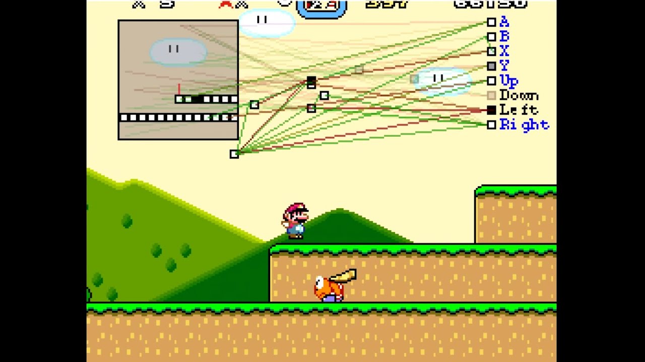

Good for reference
code that is used.
http://pastebin.com/ZZmSNaHX
