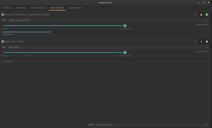

In a fit of frustration, I unplugged the headphones from the jack at the back of the Wave 3. I had PulseAudio Volume Control open, and the Wave 3 was set to “Mono Input”. Obviously, in this mode it was able to pick up sound. I plugged my headphones back into the back of the Wave 3, and change the mode to “Digital Stero (IEC958) Output + Mono Input”. It was still picking up audio, and was able to play back a video I opened to test if the output worked. It did in fact, work! However, I’m not yet convinced this is a consistent and repeatable workaround for my problem so I am hesistant to call this a solution just yet. It is unfortunate if this is a viable “solution”, but at this point I’ll take “unplugging it and plugging it back in” over nothing.
I wonder if there is anyone at Elgato I can poke to provide official support for Linux users…
I should have noticed this sooner, and I don’t know what is causing this, but when I set the configuration of my Elgato to Digital Stereo (IEC958) Output + Mono Input, the Input Devices section will also show the Monitor of Elgato Wave 3 Digital Stereo (IEC958) as an input. Why is my output being detected as an input? The actual microphone shows up as well, but nothing is being captured through the microphone. I’ve pasted an image of this below.
Before anyone asks, the output also shows up in the Output Devices tab, as it should.
Disabling the Monitor... Stereo as an input by clicking the sound icon in PulseAudio Volume Control doesn’t do anything. I suspect there’s some driver issue within Linux that has difficulty detecting/disambiguating audio channels on “complex” devices like the Elgato, but I have no idea.
However, it does work if I click around PulseAudio Volume Control enough, so it can work, I just don’t know how to make it do so consistently. Perhaps someone will see this and be able to act upon this clue.
Something seemed to work:
My microphone was not capturing any audio, but when I joined a channel in Discord and switched the Configuration to Pro Audio, it worked. And when I switched it again to Digital Stereo + Mono Input, it still worked.
I don’t know if this is a fluke, but I’m writing this down and future me will see if this can be reliably replicated. It seems weird that the microphone will only “start working” in this way.
Note how there is now a small blue bar for the Microphone; this shows it is picking up background noise, and when the microphone works, that bar is almost always there (because the computer fans are always spinning).
