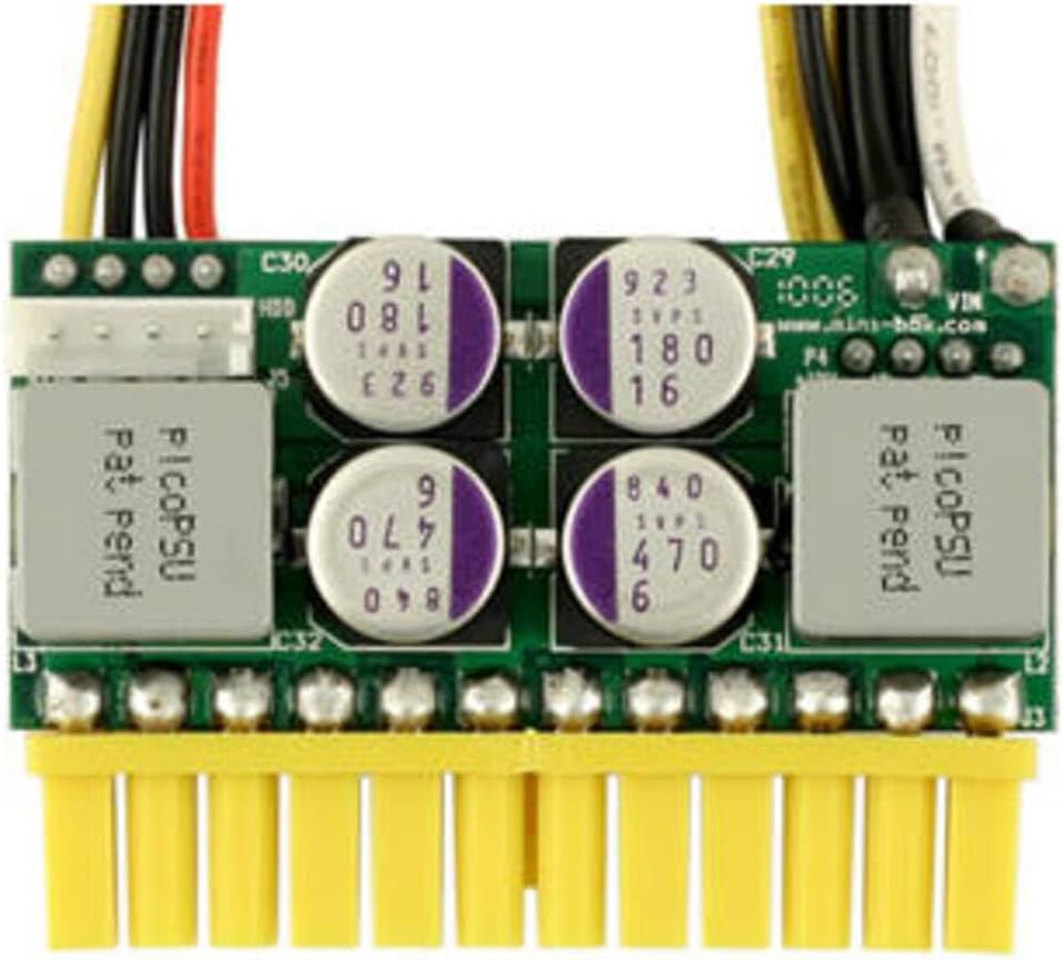

How to power more than two drives? Directly from PSU. One of the options is to use cable adapter from IDE 4Pin (Molex) to SATA power. It should be enough for 2 HDDs.
If you don’t use ATX / picoPSU and only barrel jack (for example DC connector 5.5x2.5 which is on Asrock N100DC-ITX) then only some DIY solution and custom split cable… but probably you will need DC-DC convertor(s) in order to have output 5V and 12V
source
//edit or: MINI-ITX PSU 200W NAS - Inter-Tech Elektronik Handels GmbH

Indeed. Here is one jankiest jank cables of the year but might be just what you need?
Or utilize unused fan headers, perhaps? Could only find a Swedish reference, but:
https://www.fruugo.se/hard-drive-data-power-supply-integrated-cable-small-4pin-female-sata-30-male-to-sata-22pin715p/p-119371679-250995595
Also, M2426 might be interesting for you, though I would discuss your idea with J-Hack personally:

Aight, so the M2426 is a variant of a so called PicoPSU, but might not be quite what you need as it is designed to work both as a PicoPSU and reduce cables for a more traditional setup. How about this combo then:

I need to ask the Pico PSU seller how much power can be pulled through the Molex plug.

I had totally forgotten about them, this is genious! Though I’m not sure yet because I can’t seem to find technical reviews about it or efficiency charts.
