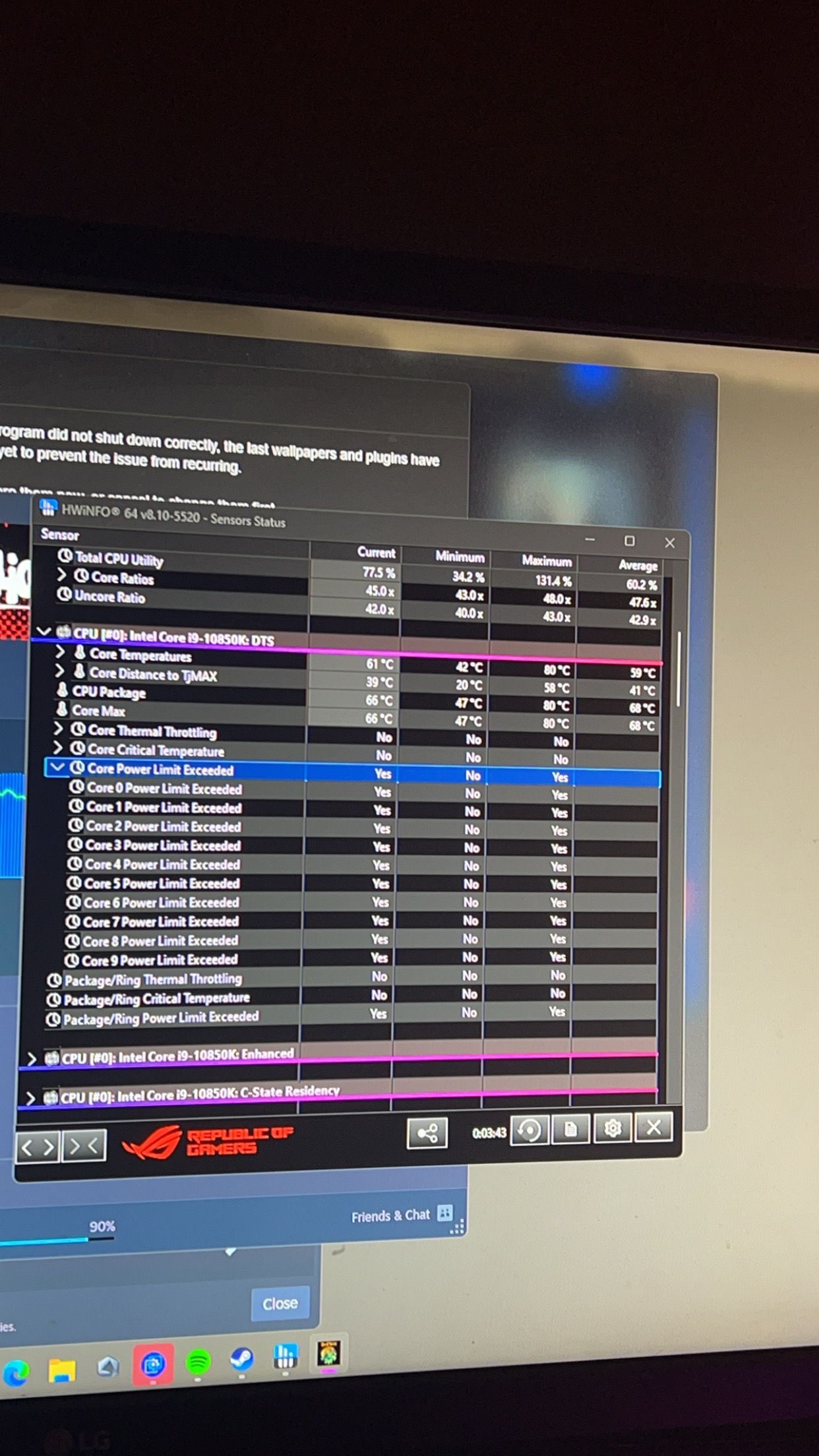

yes everything is up to date, i checked event viewer and it was event ID 41. i was looking more into it and i’m thinking its maybe an overheating problem, i ran HWinFO and when i launched a game, it would say the limit is exceeded… i’ll provide photos to help me explain
i’ve also noticed that when my room is a little warmer than usually, it tends to black screen more which is making me think it’s an overheating problem. would i have to reapply thermal paste?

This is either voltage,heat issues or both. When I was overclocking I noticed these things too. Try OCCT and do a ram check first with half your cores running during that test and see what pops up for an hour. If that is fine run the cpu test with 3/4ths of your cores and test. Those usually don’t take long to see a issue so that can run for 5-10 minutes first then if no issues longer test.

i just ordered thermal paste which is coming in today, i think im going to reapply some to my cpu and gpu to see if that fixes the issue. I found out my gpu also uses thermal pads so would u recommend me replace those too or just use thermal paste?

i used to overclock, everything is stock settings right now and the issue stays. my voltages look fine, i’ve been monitoring them the past few days and they don’t spike down or up, they stay pretty consistent.
i have thermal paste coming in today so im hoping maybe that will fix it, i’ll give an update on it whenever i reapply it
