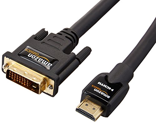

just get an HDMI to DVI adapter
also are you displays only 1440p? because you probably didn't even need a 2nd 970
The X-Star I have won't work with anything but strait DVI. Yeah I want to buy another X-Star and run them spanned.
HDMI and DVI are digital, there's no difference between the actual signal, aside from HDMI being able to carry audio, not that that matters for monitors
Yeah I have one of those, (also it's not a dual link DVI just a single link) Something about the Xstars w/o a AD board preevnt them from working with anything other than strait DVI. I could get one with the AD board but then there would be a difference in timings and I wont be able to span them.

display port to dual link DVI is a thing and would solve your problem.
even though HDMI to DVI doesn't work? I don't have the second X-Star yet but hope to acquire soon. I only want to run 2. Right now I have a DP2710LED and a Benq which I will move to the living room once I p/u a Xstar or Qnix.

HDMI to DVI should work just need a box from radioshack or bestbuy to convert the signal. the display port to DVi is a little dongle and can be found at best buy or radioshack (quain would love my local shack still has all the little DIY parts)
