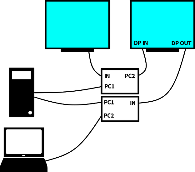

My father has a triple-monitor PC setup for gaming. He would like to be able to connect two of them to either his PC or his work laptop. Problem is, all displays should be individually connected to the PC for maximum performance, while a single Thunderbolt connection should be used on the work laptop for maximum convenience. It’s a bit of a head scratcher for me, all I could come up with was a complex dual-KVM idea that also requires a display that supports Multi-Stream Transport:
Is there a simpler and/or cheaper alternative to this?

Just coming back to say that I have found a potential solution, letting you know in case you’re interested.
The solution only requires a KVM with two monitors outputs, two DP or HDMI inputs for the PC, and one USB-C input that supports a bunch of protocols (USB for passing through the mouse and keyboard, DP MST for the two screens, USB-PD to recharge the laptop). No new monitor, docking station, or USB hub required. Wendell has such KVM, as well as AV Access.

The 4 port dual PC KVM on the level1 store will do the trick here.
Challenge is the MST. Grab a thunderbolt dock that has multiple DP outputs and you should be fine. The concern, depending on the monitor specs is going to be signal degradation. Generally speaking, you want to keep the total cable run length below 4 meters.
The good thing is that you can use a remote (basically just a USB macropad that shows up as a basic HID) to operate the buttons if you need to.
