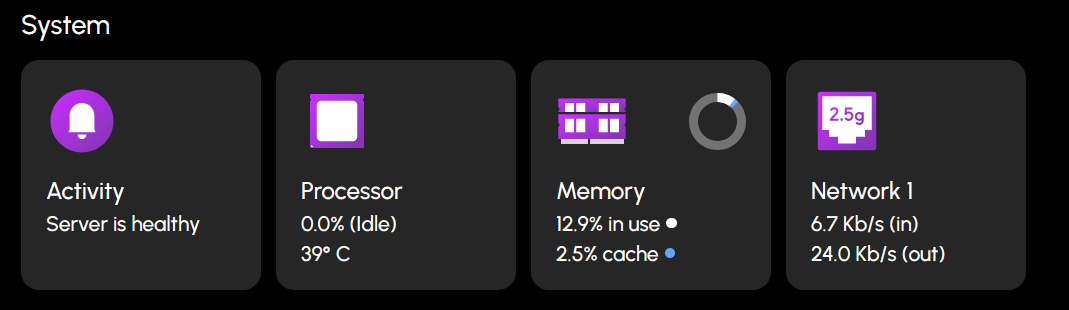

Below is a system usage from the server, historically, the RAM usage would site close to 100% usage, which I believe is by design with TrueNAS. However, as you can see it no where near that right now, which leads me to believe it is something with the drives.
Any troubleshooting tips would be appreciated.
For those who may find this in the future, the issue appears to be an inter-vlan routing issue. I am opening a ticket with Unifi support and will update if they provide any useful information.
