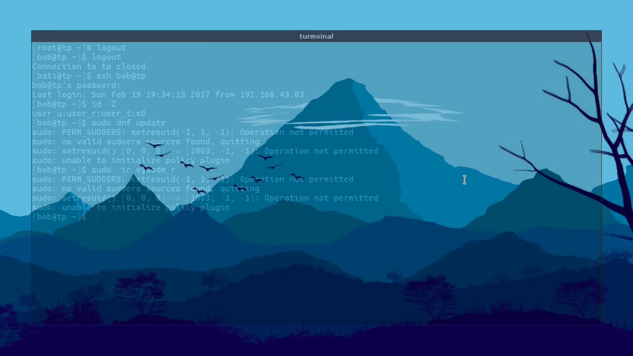

setenforce 0 doesn't work if the root user is confined, the root user would need to change to for example selinux sysadmin user & role which can set the sestatus, which again, should be set to a different password than root has.
Ootb in linux selinux doesn't confine users at all, everyone is unconfined, and it's the unconfined rule that is the biggest weakness regarding security, since it means users can do whatever they want.
It's up to the admin to confine the users, but there's preconfigured selinux user roles that can easily be set, like user_u for normal users and sysadm_u for root.
