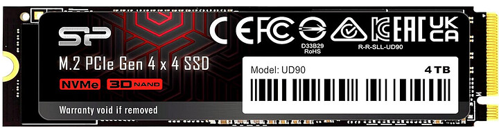

4TB Silicon Power UD90 - $162. Now I can have ALL my serious software and games on one drive and not have to worry about space for a little while.
It is DRAMless I believe. Reviews said it was pretty good. I had a Samsung 990 Pro but my 10850K CPU bottlenecked it to half speed. gen 3 - 3,500 MB/s. I figured it was a waste to have a bottlenecked Samsung so I replaced it and sold it.
The SP-UD90 runs about the same as the 990Pro. 3,500 Reads & Writes. Your speed should be closer to 7,000MB/s with PCIe gen 4x4.

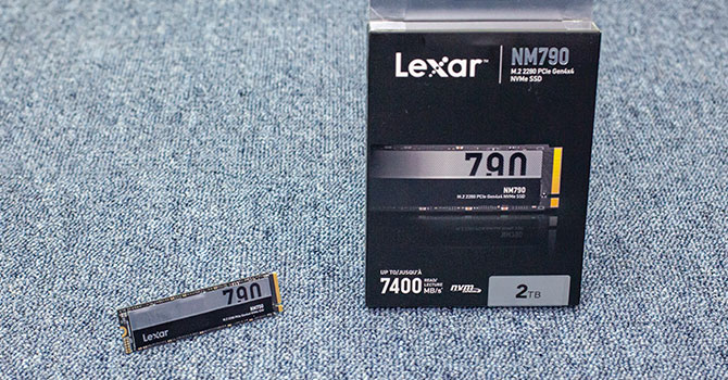

This modern dramless lexar drive for example shows excellent performance, and is probably the best (or one of the best) value SSDs out there at the moment:
good review for it, got a question if you happen to know, is the system memory stuff it does motherboard dependant or is it os dependant? I have a 370x taichi for a 1700 ryzen, it’s kind of getting up there in age, so my concern is if that doesn’t work, also if you know, how much space does it actually use? I know that samsung has 512-1gb on their drives for dram, and while I have 64gb, I frequently use all of it so it is a bit of a concern.
If the ssd has HMB (host memory buffer) enabled then you are set. There are no additional requirements. Maximum amount of used host memory should be 1GB per TB of storage, so no worries.
Just avoid extremely cheap dramless drives like Silicon Power above or worse. These are really unpredictable, both in performance, endurance and reliability.
Generally speaking the dramless drive segment, being the cheapest of the cheap, has the most variability. Top of line drive have excellent performance, satisfying even most demanding users. Trash on the bottom is literally wasted money, since they can perform worse that even hard drives when under load.
There are some horror stories around, latest one was Silicon Power SATA drive.
