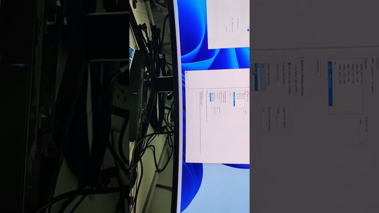

hey, I have some new intel from trying a bunch of stuff on my end.
I updated my nvidia driver on my ancient machine and I found something, maybe
can you use the nvidia control panel and setup your control panel the same way:
(sorry its sideways)

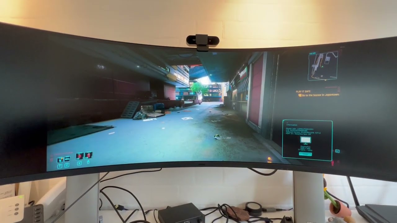

I’ve finally got some good news! After trying 26 different combinations of DP cable, I have Finally found two cables that work well together!!
With cable 1 as the PC → KVM cable, and cable B as the KVM → monitor cable, it’s been holding a signal for 4 1/2 hours and counting!!
Why did those same two cables the other way round only work for 8 minutes? I have 0 clue, absolutely none. But this really seems to work. I already tried them for 3+ hrs yesterday, and today I’m going to see just how long the signal lasts for. So far… it doesn’t seem to be stopping
I really think my problem all this time has just been cables. Which I would say makes me very, very unlucky If these two cables really work flawlessly then… wow. I really had to put some work in to get this thing going! Totally worth it lol
