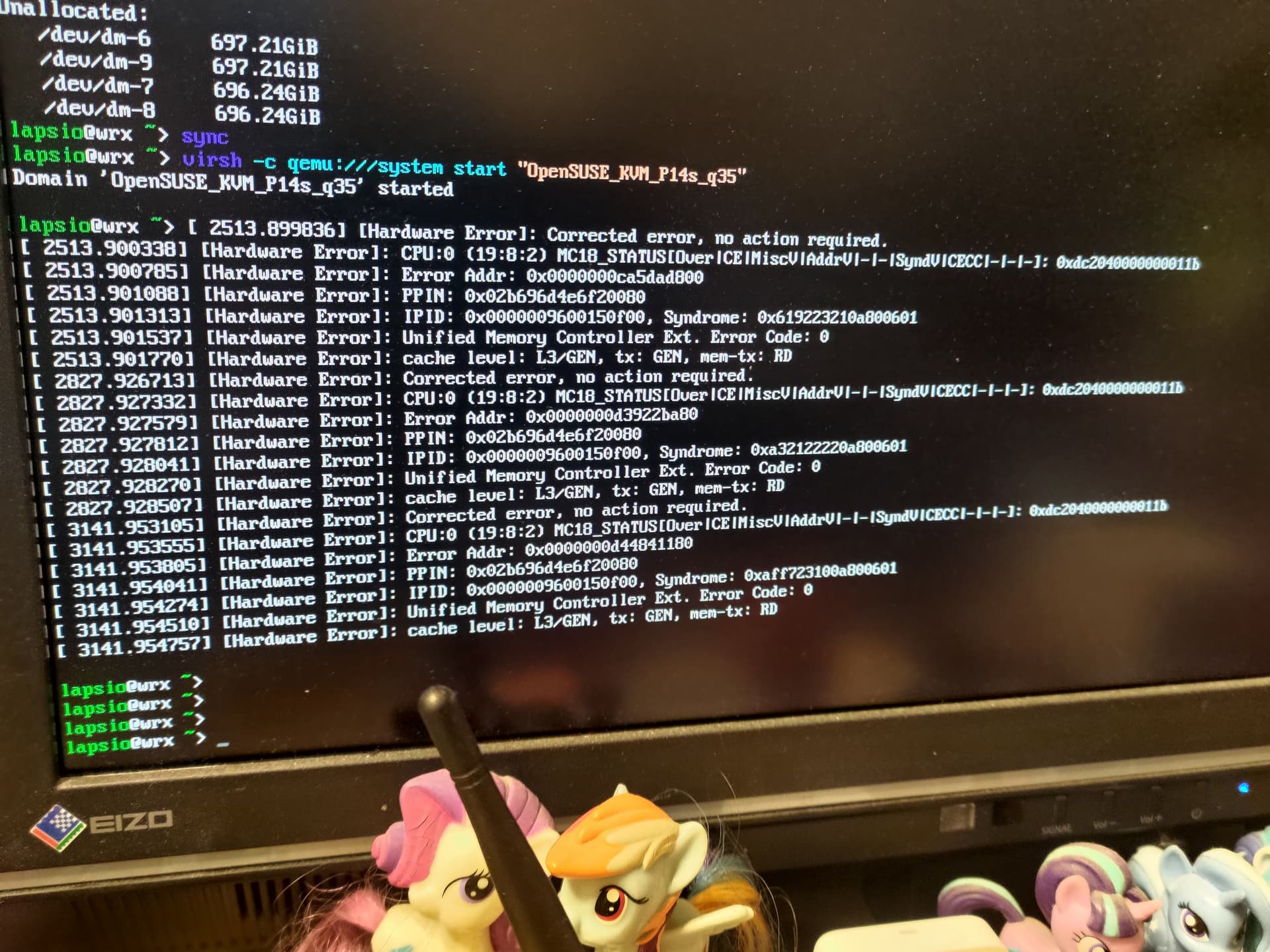

I tested machine and didn’t notice anything extraordinary - sticks are running at 3200 mhz like they should so idk what’s going on. I decided to test my real use cases and while they work functionally fine, I noticed quite a bunch of ECC errors in dmesg. All of them corrected but well… kinda sus. Like 20 errors in 1 hour. I had 0 ECC errors with 256gb config.

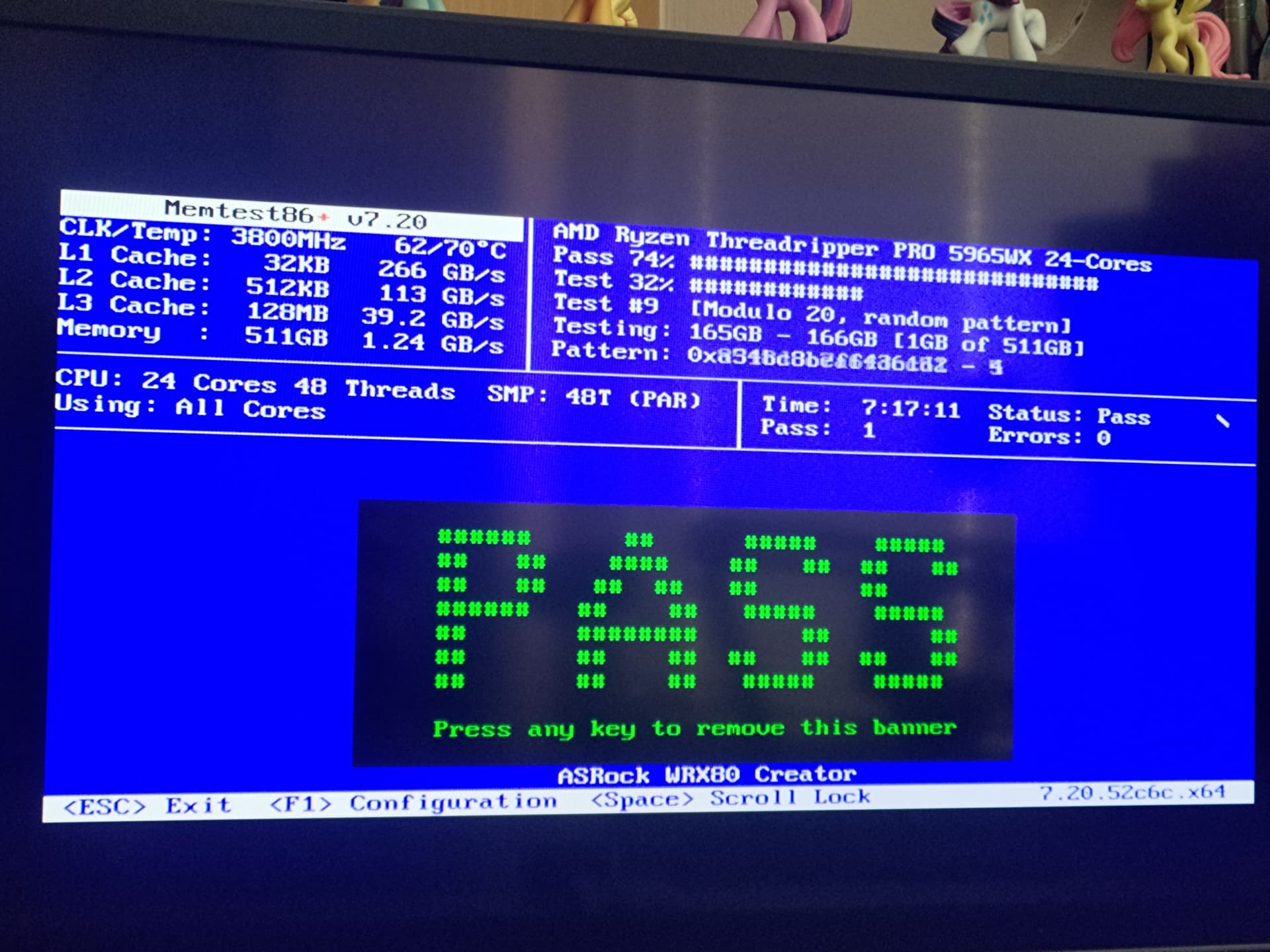

I’ve run memtest86 with ECC enabled and it returned 0 errors:
However then I’m using machine regularly it still sometimes catches ECC error :C
So i noticed that those errors are fairly peculiar. They occur precisely every 5 minutes. And only ONE every 5 minutes.
