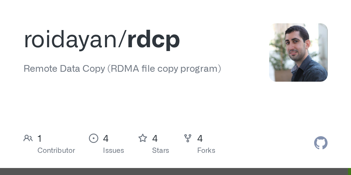

If there are no access issues, then the next thing that you can do is to try and see if you can send a decently large file over (e.g. 10 GiB file if you have one) (and you want a decent large file) because you want there to be enough time to see if your GUI system monitor is going to see the network traffic or not. (With RDMA, you shouldn’t see the network traffic in system monitor because that’s kind of the whole point of RDMA (bypassing the network stack).
rsync can be useful because it can still report the transfer rate over RDMA. (Or if you are just using the GUI for a normal copy operation, that should still be able to tell you what the transfer rate is and system monitor still won’t show it despite that. Or at least this is true in CentOS 7.7.1908.)

I just googled “RDMA copy” and this is a project that came up:
So…might be worthwhile for you to look into to see if that might help reduce your CPU load even further, if you really want/need/or otherwise interested in trying to do so.
