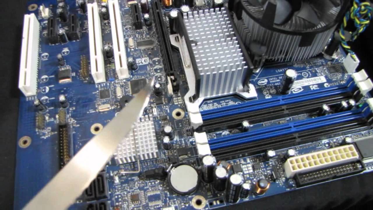

Also I guess I should link the Linus video. Don’t try at home kids.
Ahh I see. If it’s an open slot then you could stick a x16 card in it at x1 I think?
As @thro and @cowphrase mentioned, a PCIe device with x16 long connectors, should work in a shorter socket, as long as the end is not sealed.
It would just be restricted in bandwidth/performance.
That is data wise.
