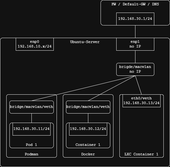

I want to have a Ubuntu Server (24 LTS) that runs Docker containers, LXC containers and Podman pods at the same time. Container services have to be able to communicate with each other and the rest of the network e.g. Internet.
The host has 2 NICs, one purely for management and the other for container services only (the host has no IP on this NIC).
Pods have to run in rootless mode.

This is what I would like to achieve:
container_networking
How can I implement this? I would like for each container to have its very own ip but also mac address so that each appears as a real client on the network. That is the reason I tried to implement this with macvlan.
Any help is welcome. Thank you
