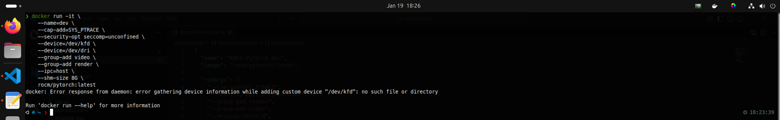

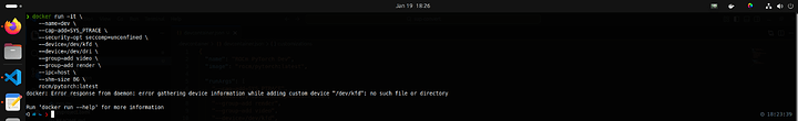

And herein lies the crux of the issue. Specifically with /dev/kfd which docker won’t get access to when run without sudo.
docker: Error response from daemon: error gathering device information while adding custom device "/dev/kfd": no such file or directory

had actually tried adding both options late last night, before heading to bed but sadly not luck, after I noticed both the official AMD tutorial and the guide only required the --groud-add video be present (full example below).
I just tried it again, just for my own sanity and no dice. Also the system has been rebooted at least twice since now and then.
the user running the docker container should have been taken care off by an additional step in the official guide
sudo usermod -a -G render,video $LOGNAME
which I just copy and pasted upon setup.
docker run -it \
    --name=dev \
    --cap-add=SYS_PTRACE \
    --security-opt seccomp=unconfined \
    --device=/dev/kfd \
    --device=/dev/dri \
    --group-add video \
    --group-add render \
    --ipc=host \
    --shm-size 8G \
    rocm/pytorch:latest
