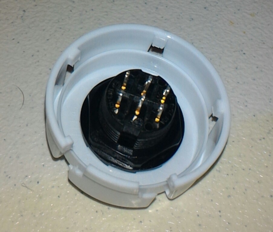

My solution for mounting the toggle switch. Yes, a pill bottle cap.
Rear of cap.
Shortened up the bottle and put a split in it to get it over the wires later.
