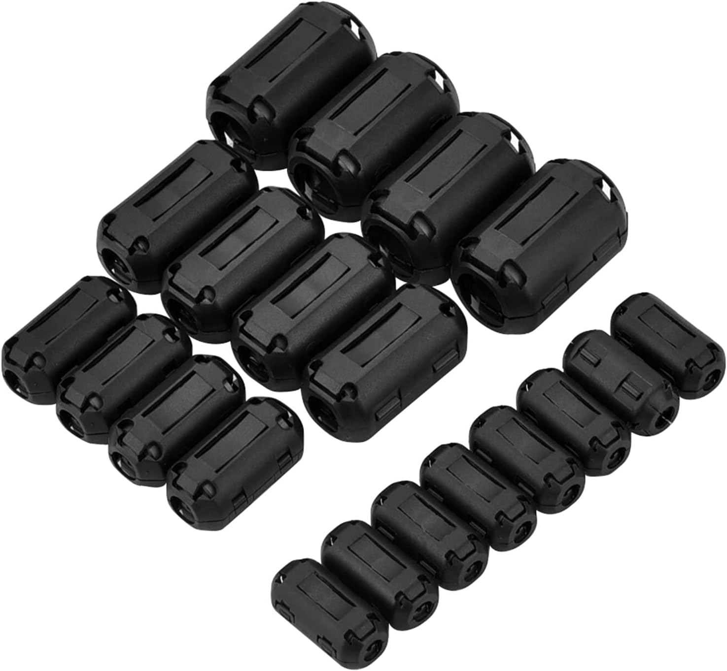

I suspect the signal is “borderline” or one of your cables is picking up outside interference from something.
You could try adding some ferrite clips which help squelch outside interference:
or pickup some Club3d DP cables which are higher quality and that will more likely clear things up for you.

There’s about 4 training levels a monitor can do tomorrow to negotiate with the GPU that happens at a pretty low level. If you were training at max, level 4, and with club3d level3 is too little but level4 is too much then you can be in a weird no man’s land of snr ratio. Sometimes a ferrite bead cleas that up
So maybe try a ferrite bead on your right angle cable?

I tried putting a ferrite bead on the right angle adapter. It helped a bit but the signal still dropped out frequently. I’ve also tried a different right angle adapter which has the same issue but less often. I have Club3d cables on both sides of the KVM.

There is a bit of black magic to the ferrite beads, for sure. You might need two. Try two on the right angle adapter, about 1.5cm away from each end of the cable?

The adapter is actually not long enough to have two beads, more than half of it is inside of the case. I’ll just keep with the current setup of adapter + bead + original cables and see if the signal still drops. So far it hasn’t, but these cables would only have that issue every few days so it might be a while.
