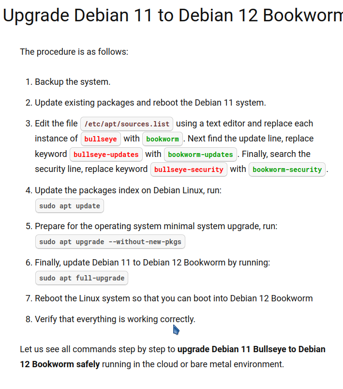

I was using Debian Bullseye for about a year. Then Debian 12 Bookworm was released and it was advised to upgrade since Bullseye will eventually stop getting updated. I followed some generic guide on how to simply update the apt sources to point to bookworm instead. Everything is working fine now for a month. But now when I runt sudo apt update, it never finds any updates. In my experience, there is almost always updates to install when I search for updates.

Upgrading between versions is more than just redirecting your repositories.
