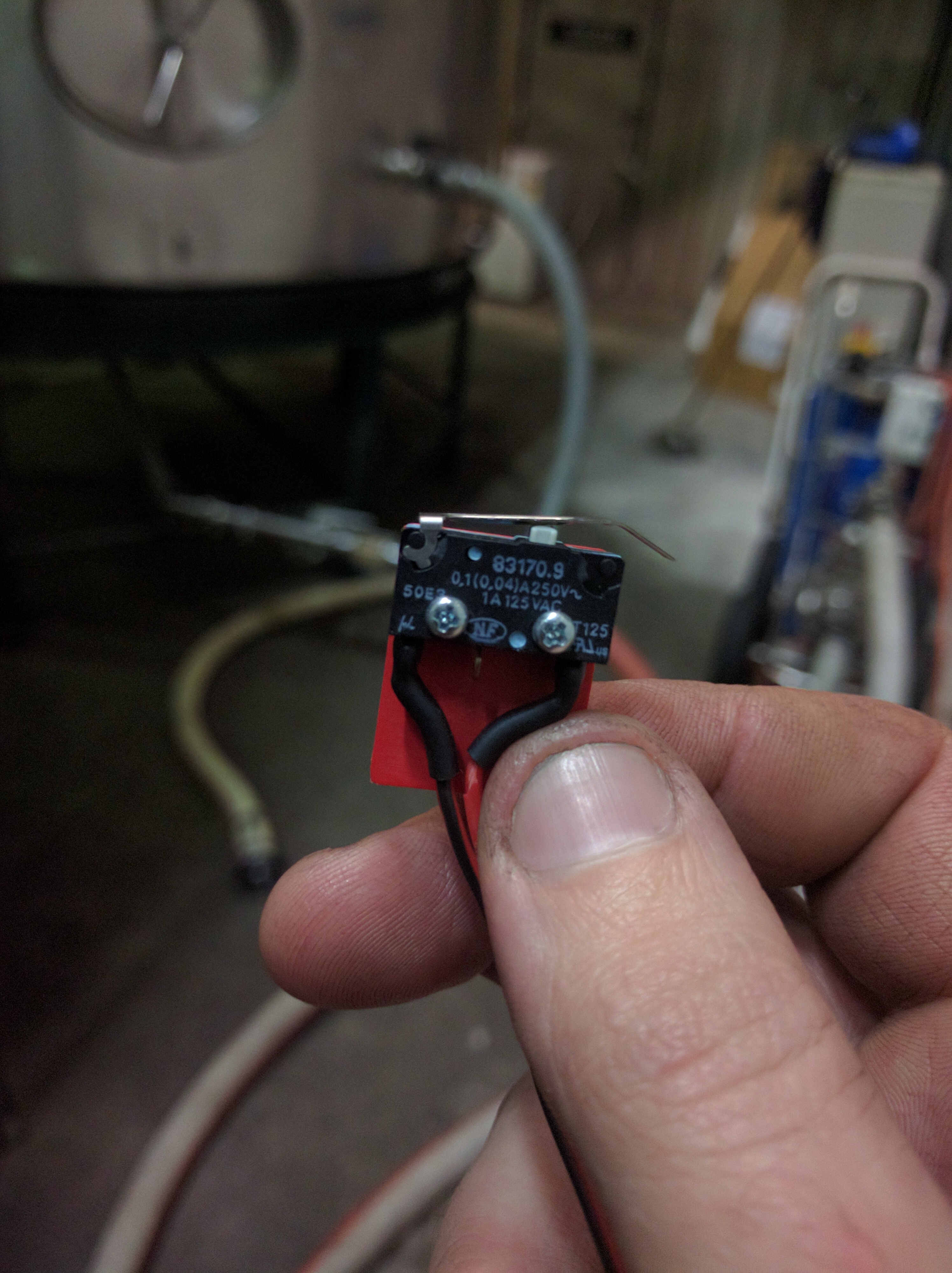

Just found this at work, should make a good case intrusion switch
Perfect, seems to have contacts for both an closing and opening actuation =)

I can have the micro switches for the case intrusion detection and arming/disarming the system between the relay and the reset header. Or am I missing something?

The dissarm opening contact can be on the RESET side; The intrusion and mercury must be on the primarry side of the relay
Thanks, I think I've got it now.
I think Hillary Clinton should have hired this guy.
Actually, if all the contacts that you are using are closing contacts (so they close the circuit when they are actuated) you dont need the relay.
Than you just put the case, movement switches parallel and the opening contact in series so you can inhibit the reset; that way you do not need external power.
