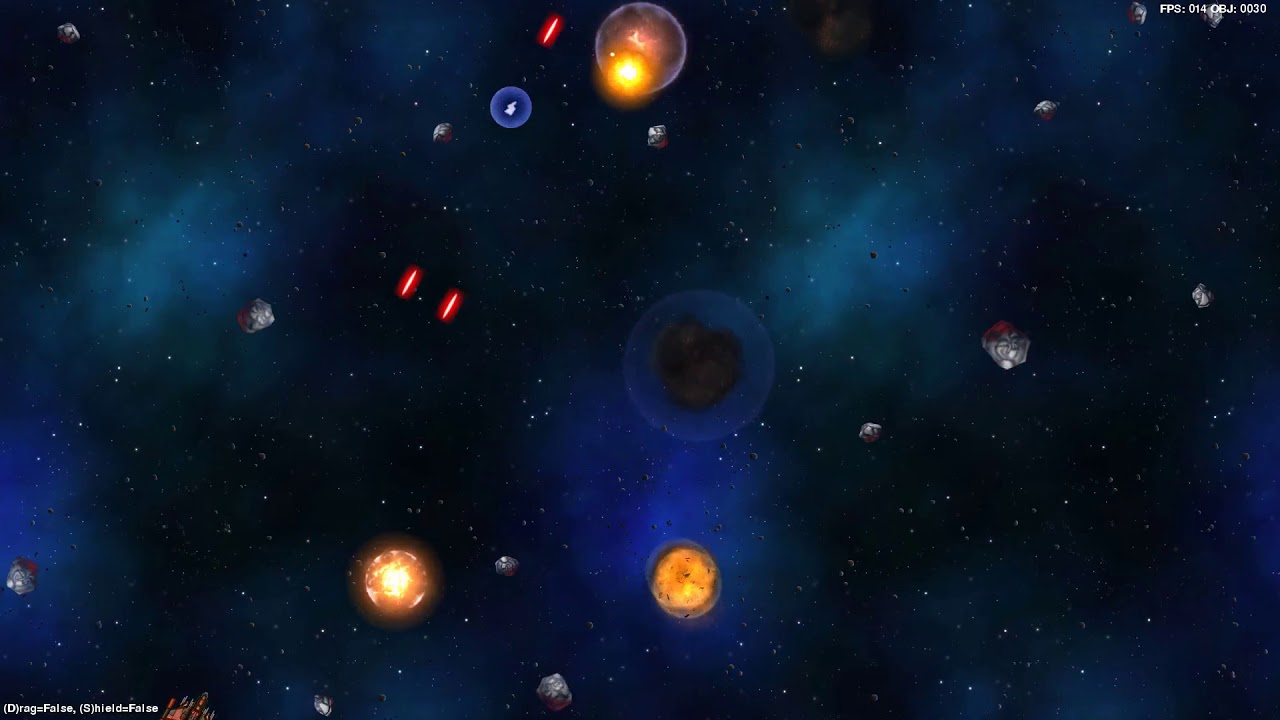

Here’s how the new power ups look anyway:
Cheers,
Shecks

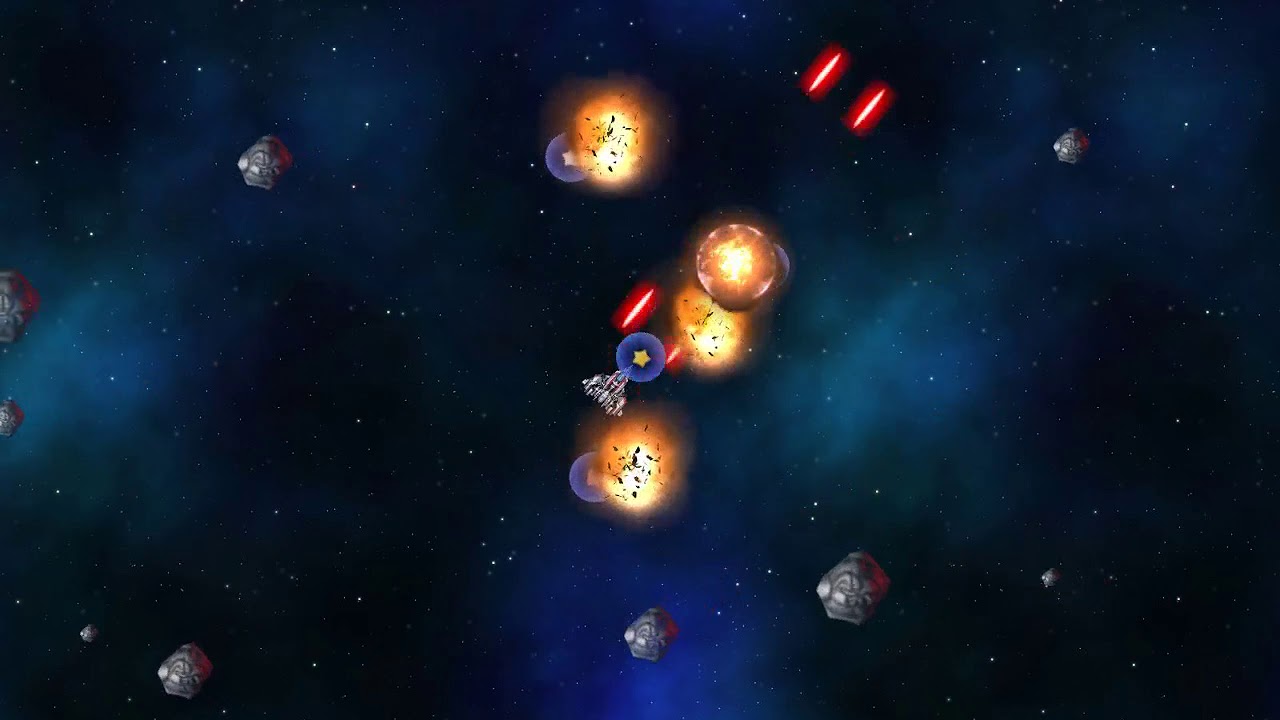

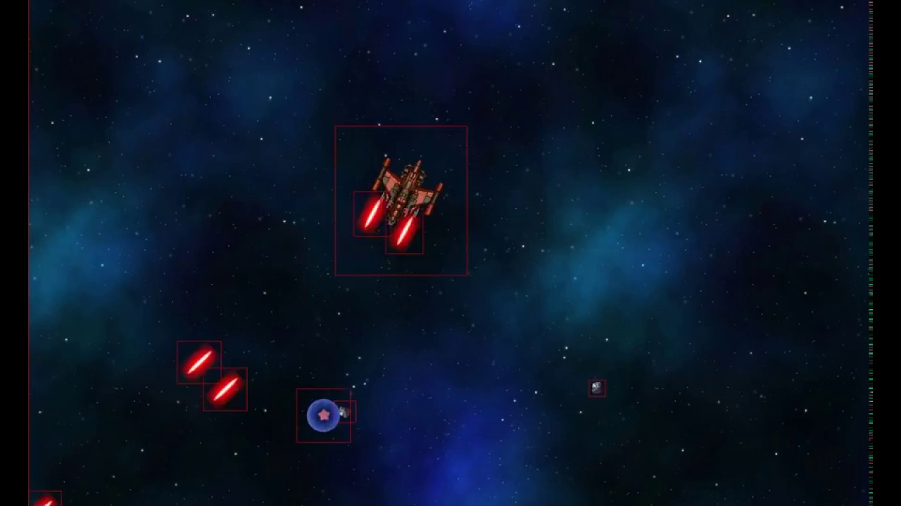

Day 13 (FIRE!!!)
Finally got my head around the school level trigonometry I needed to implement the double shot weapon :rofl:
I also increased the velocity of the main weapon so it’s starting to feel a little more like an actual game now (I’m still using the bounding rectangles for collision detection which are far too large so even I can hit the rocks)
Shecks

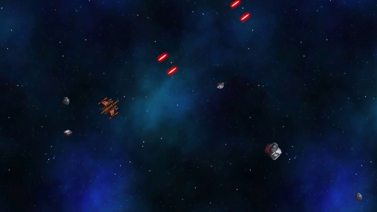

Day 14 (New Toys)
As a bonus side effect of #devember, I’m getting a lot more experience with GNU Gimp. I still can’t draw but thanks to Skorpio’s excellent Space Ship Construction Kit on Open Game Art … I’ve got a new space ship :sunglasses:
It’s probably more efficient to draw all the different components of the ship separately at run time but I’m lazy and figured I might have issues placing the parts due to distortion when rotating the ship, so I decided put all the different combinations (stationary ship, ship with engines on, ship firing main cannon, ship firing main cannon with engines on etc) in one sprite sheet and see how it works out.
Shecks

Anyway here is how it looks at the moment. I’ve added two ships (and started abstracting all the common movement code so different ships can have different behavours and stats) and also added code to break up the asteroids when they explode.
Cheers,
Shecks

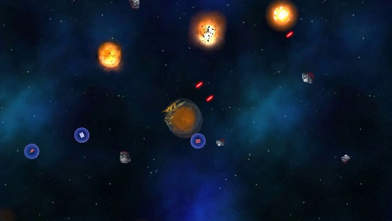

Anyway, here’s a quick demo
Cheers,
Shecks

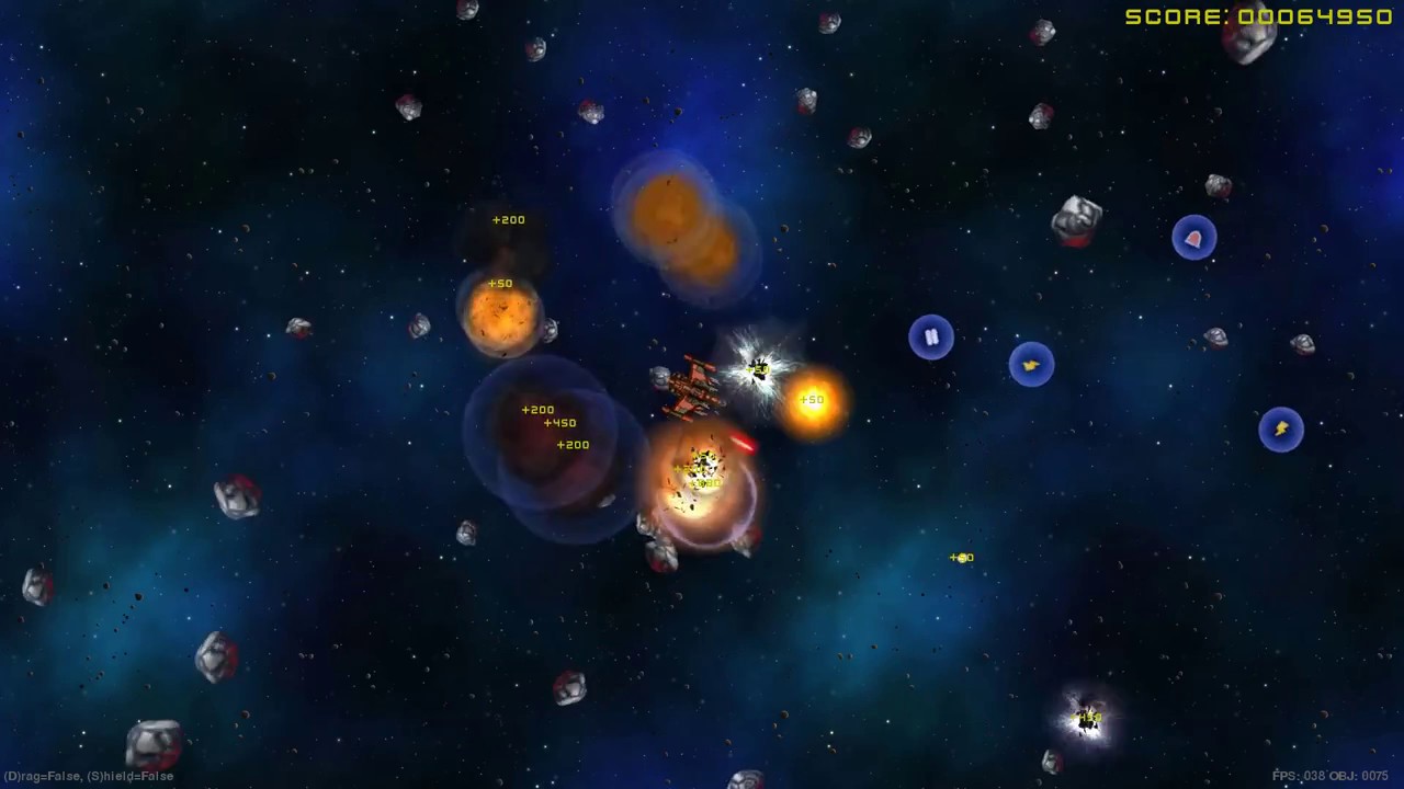

Anyway, here’s the state of play at the end of #devember
If anyone does want to try it out, you can hit the ‘Escape’ key to spawn more asteroids, ‘D’ toggles friction/drag on the ships movement (a feature I was playing about with) and ‘S’ to do nothing (at one point I was using this to test the ships shield)
Cheers,
