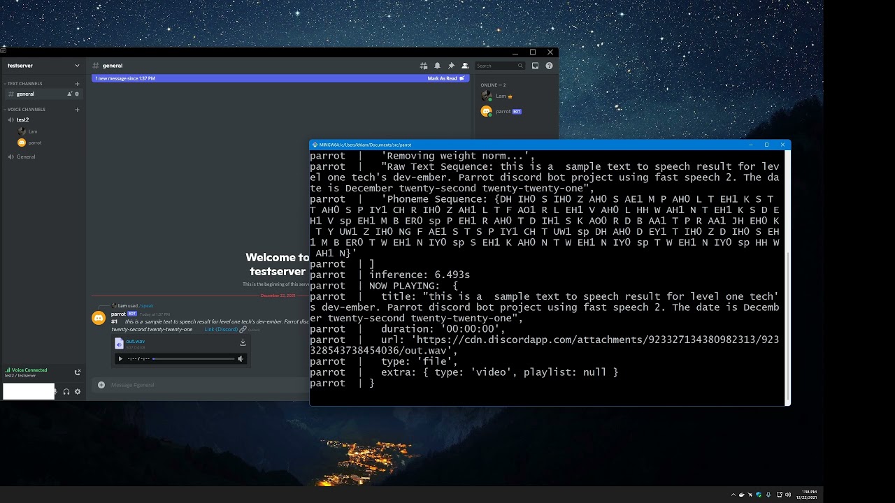

  3. Instead of voice commands, I’ve decided to add the inference component of FastSpeech2 to the bot. Paper: [2006.04558] FastSpeech 2: Fast and High-Quality End-to-End Text to Speech
    Github: GitHub - ming024/FastSpeech2: An implementation of Microsoft's "FastSpeech 2: Fast and High-Quality End-to-End Text to Speech"
Essentially, the bot program-call-flow shall be:
  • user types in a string to be translated to TTS
  • A sub-process calls the python script to run inference
  • Wav file of the string is written to /tmp/
  • Wav file is uploaded to discord’s servers and get URL
  • Delete local wav file
  • Add TTS URL to music queue
This all works and my code is in the github repo, now I need to figure out if this code is lightweight enough to run on a free heroku server, and if that doesn’t work, can a small linode instance work instead?
I’m might incorporate these models, https://voice-sharing-hub.herokuapp.com/
so the bot has multiple TTS voices.
This is turning into a long-term never finished project, but my dream is to build a markdown parser into this bot so users can write a story into a discord channel and the bot reads their words back to them.
In this vein of thought, it would be really cool if you could have emojis as placeholders for sound effects, so for example if someone wrote the tts command:
  • “:door::door::door: hello is anybody there”
The bot would compile a .wav file with the sound effect of three door knocks followed by the TTS.
Here’s a video demonstration of the bot transcribing a short sentence.
