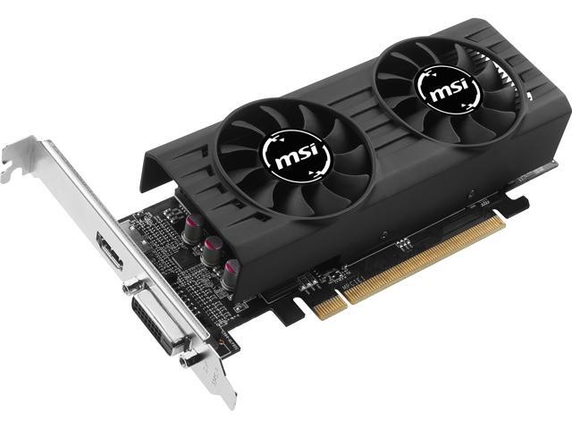

I'd say go for one of the low profile RX 460s or 1050s
similar performance, similar power draw, etc.
The RX 460 probably will be cheaper.
vs 1050
so the RX 460 is like $30 less.
Shouldn't have any isues really power wise as they both use just the PCIE power.
If you can fit a full sized GPU I would agree with the RX 470 you wanted to get.
This, everything seems fine, but getting a 'PCI slot power only' GPU would definitely help your chances.
