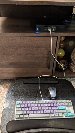

I got a stack of five 7050 micro motherboards for $50, slowly making machines out of them.
So far, I’ve put one in a cheap af 3020m case shipped from China, fits great (just had to chop away metal around DSUB connector hole to make way for HDMI)
Side tip: oscillating tool + carbide blade for cutting cases is way better than Dremel cutting wheel, and there’s no sparks! (YOU know what I’m talking about…) :wink:

Pics of El McCheapIO von Frankendell:
