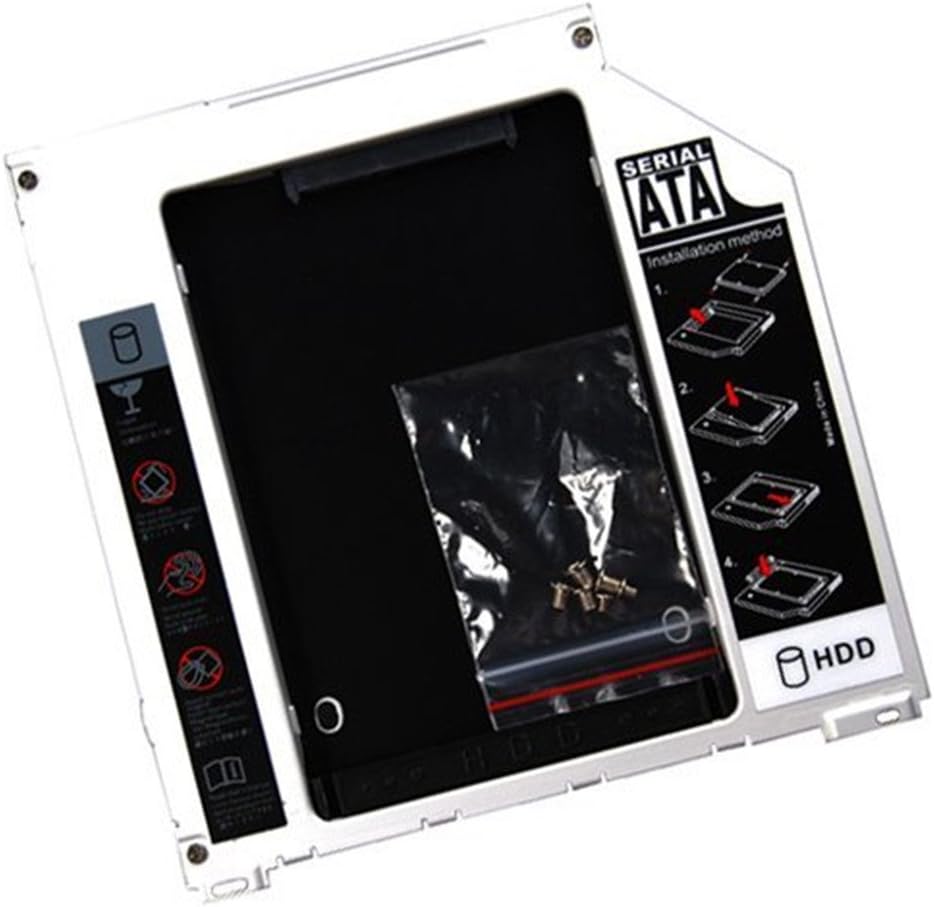

So my only other option would be to replace the CD drive bay with a HDD caddy but I'm not sure if you'd be able to install a Windows onto the drive even if you used a caddy but I know that it's a SATA port and it should be able to right? Because the error message above said it's not supported in USB or IEEE but this is SATA port so would anyone know if this method would work?

This will work, SATA is SATA. It will be recognized as a drive mount point.

I have to report that the hard drive caddy does not work. The computer does not detect this one as well :confused:
