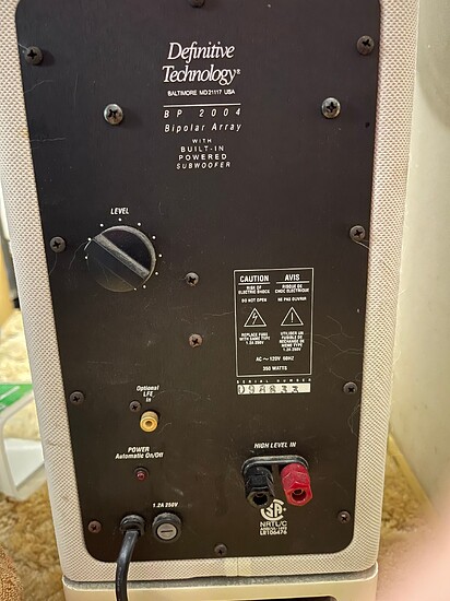

let me find some … oh crap i meant to attach a pic of the back of one.

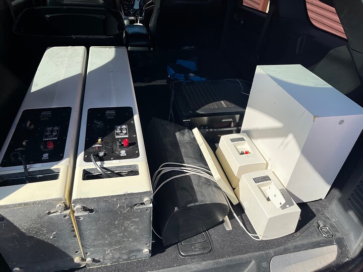

Gimme a few to find the ones I took in the thrift shop before I bought them.
The only thing I couldn’t test was the sub that goes with the Subsat6 setup because it’s apparently passive and as you can see has a left/right channel input, and since the Sony DB830 couldn’t get any sound output I couldn’t test it, but pretty sure it works.
Now that I posted pics, nobody knows anything about them?

Well, there aren’t any grilles on these towers at all, they are covered in cloth all the way around, and I assume it’s some kind of acoustic cloth to allow for frequency movement.

All the speakers work and sound great, like I said except for the Boston sub that I couldn’t test since I had no way to connect to anything. It’s the first sub I’ve actually encountered that had a left/right input, seen pictures, never actually had one.

The Boston sub you’ll hook up like regular speakers using speaker wire and the bare wire terminals from the receiver. Typically they’ll have sets of in/out terminals so you can loop through the sub and out to the main left/right, but that sub seems like it may have been part of a set or came with a specific amp.

Yeh, the condition of the cloth is not bad, but the top and bottom covers are some kind of “porcelain” veneer and they are gross AF, I think somebody’s dog pissed on them. The top ones just pop off and i’ve cleaned them the best I can but they are scuffed to hell and back. They are kind of an off-white cream color, so I was just considering painting them. I want to replace the cloth, but it’s tucked in behind the terminal panel on the back of the towers. I was thinking taking them to a local A/V shop here and see if they can clean them up and recloth them.
IIRC, Definitive cloth/grilles are glued in spots. The cream color could just be the lacquer/clear-coat yellowing with time. That terminal panel is very easy to take off; all you do is unscrew the panel. Use care when removing the panel though as there are internal speaker connections. And then when you put it back don’t over tighten the screws.
yeh, the part the internal connections is where I don’t want to screw up myself.
