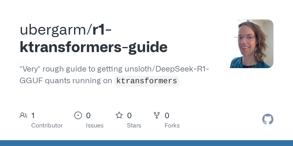

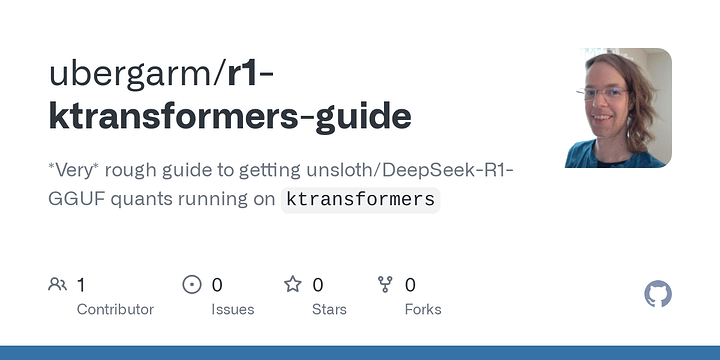

If any intrepid hacker wants to try this sketchy approach to running the unsloth R1 quants with ktransformers instead of llama.cpp it may give more tok/sec in less VRAM! If it even works right lol…
I tossed together a rough manic guide lol:
