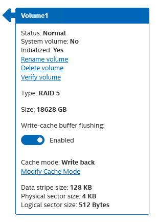

Bumping this thread.
Can’t seem to resolve this. Screenshots below are using Caja. I’ve also tried Thundar but have only gotten SLOWER speeds.
Transferring over a wired connection, starting at 80MB/sec dropping to 26MB/s. No matter what where and how I transfer files between internal and external drives, the speed collapses.
This time using a 670p to take out any factor of the Solidigm drives being the cause.
Guys, you wont believe how much of an idiot I am. I think after realigning the drive its fine.
