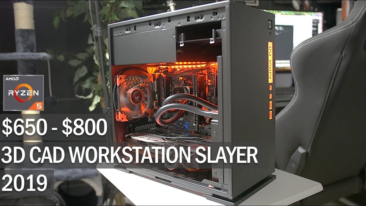

This is a very honest youtube channel, he does delve into spec:
although a few years old, it really illustrates how a newbee doesn’t necessarily need high spec gear:
