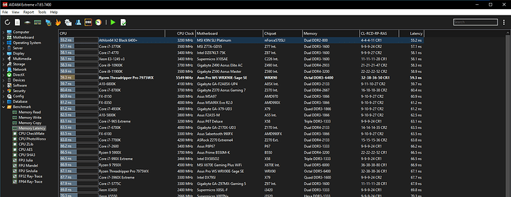

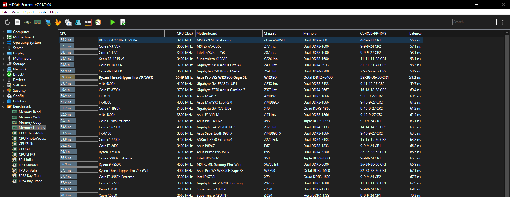

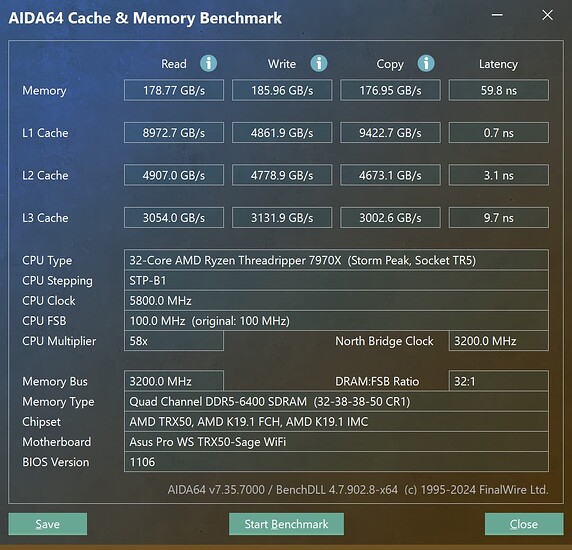

TR PRO 7975WX at DDR5-6400 with 1.3V VDD/VDDQ/VDDIO_S3 boosting to 5550MHz:
Like previously indicated, sub-60ns access latency.
dang, that’s the best I’ve seen yet on TR Pro

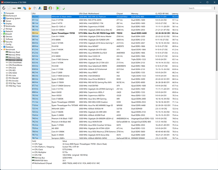

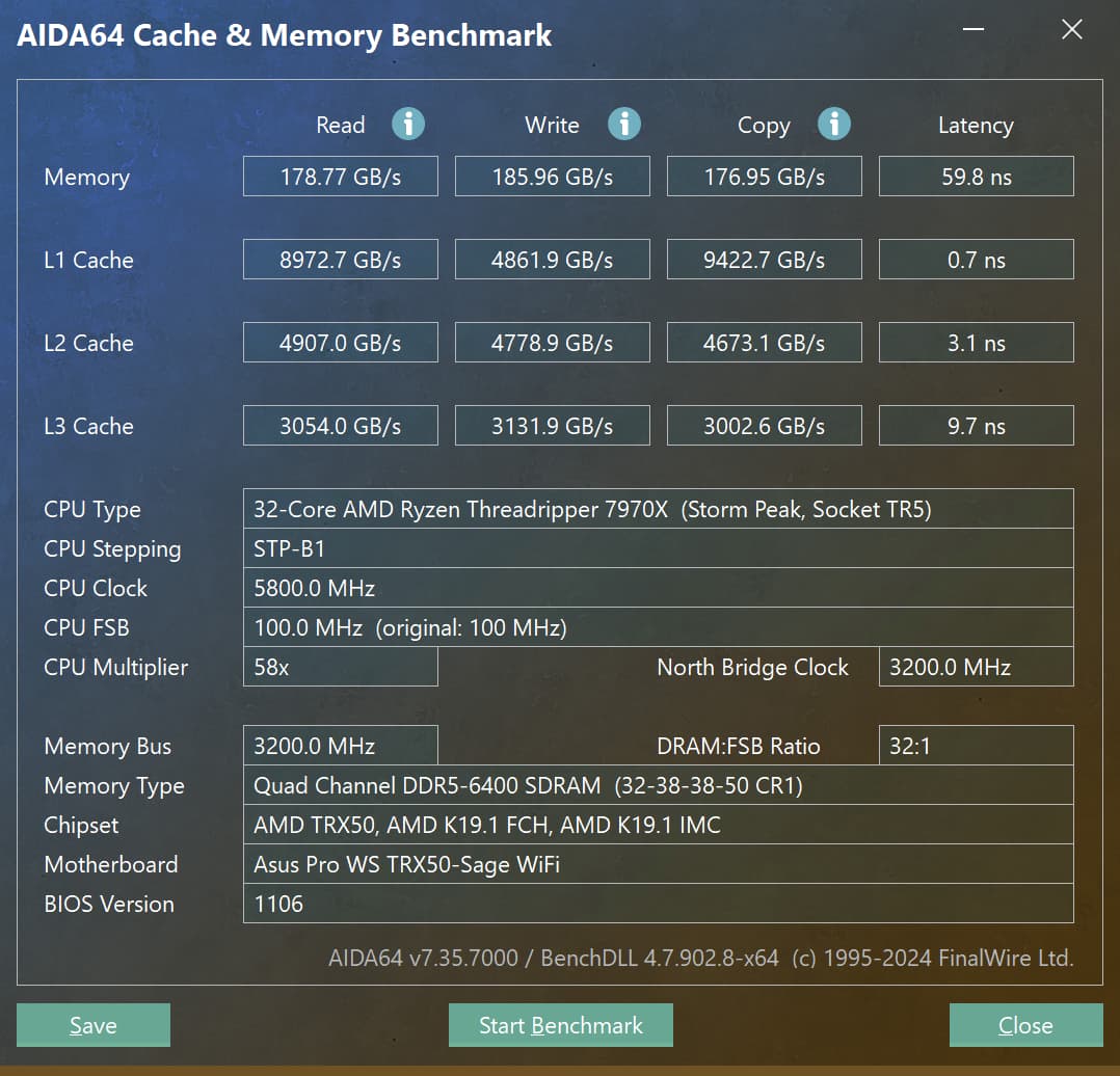

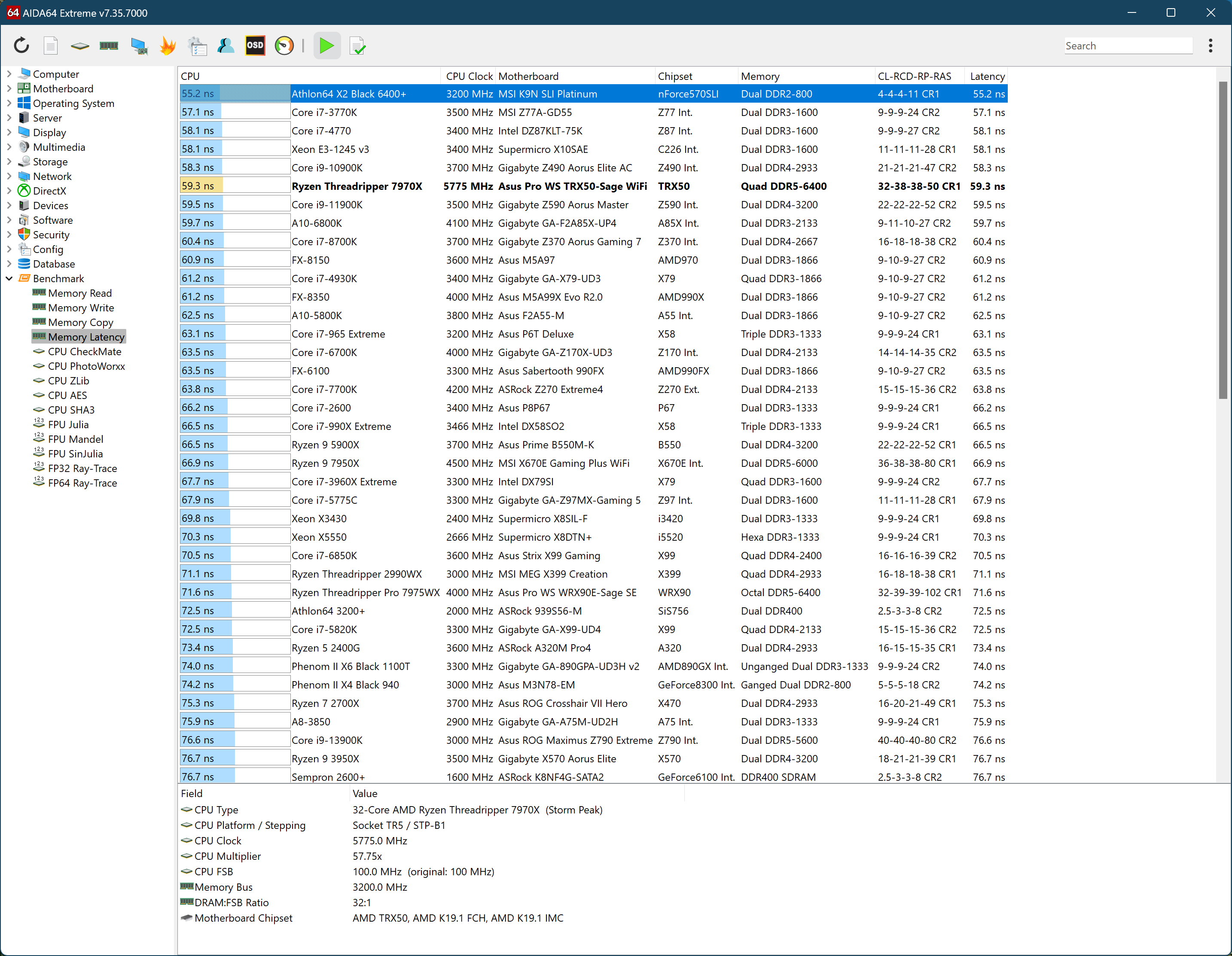

Interestingly, I use the exact Zen timings you posted in New Workstation | Buy Zen 5 EPYC Now or Wait for Zen 5 Threadripper? - Hardware Hub / Build a PC - Level1Techs Forums on a 7970X/Asus Sage, and am only getting 65ns at best in the same test.
Shimada Peak removed the MCLK=UCLK option, so latency tanked.

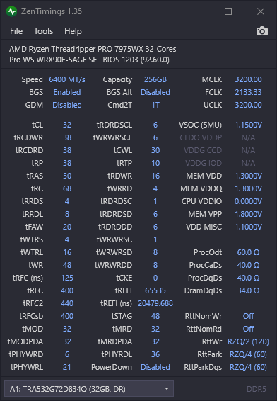

If your timings differ from the ones you posted before, I’d be interested in an update.

Be sure to also DISABLE Security Memory Encryption (SMEE).
Also, set APBDIS to 1 and DFPState to 0 as well as DF CStates to 0 to avoid IF latency hits at the start of streaming loads.
Finally, I recommend NPS4 for NUMA.

Well those settings worked, but NUMA4 is still making my builds slower (by about 5%).
I get about 66ns in NUMA1.
