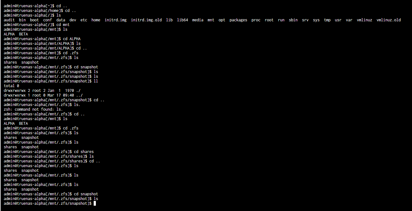

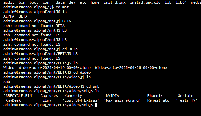

There is no data visible in /mnt/ALPHA. i dis ls, it does not return data. But I’m not surprised by that. It is expected. ZVOL is a block device. It works differently, normal dataset will expose files. For example:

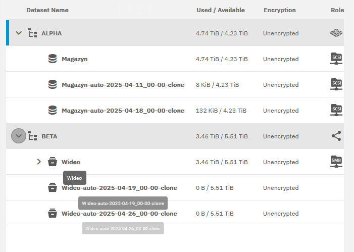

I think that i should zfs promote Magazyn-auto-2025-04-11_00-00-clone but i need to put the promoted VOLUME to second HDD where i have free space. I’m looking for solution on TreNAS forum simultaneity. I will share final solution.
obraz
What im trying to tell you is, you dont need to promote the snapshot, you need to make a clone zvol based on the snapshot. Promoting is usefull when you need to break the dependency so you can delete the snapshot a clone was created from later. You would not have this issue because once you get your file you will be deleteing the cloned zvol based on the snapshot removing any need to promote it to be able to delete the snapshot later.
Basicly i believe when looking at the snapshots you want to click on the snapshot and click clone to new dataset. This wil make a new dataset that is a clone based on the snapshot. You dont need to promote this clone in order to use it.
You look like you already have multiple cones.

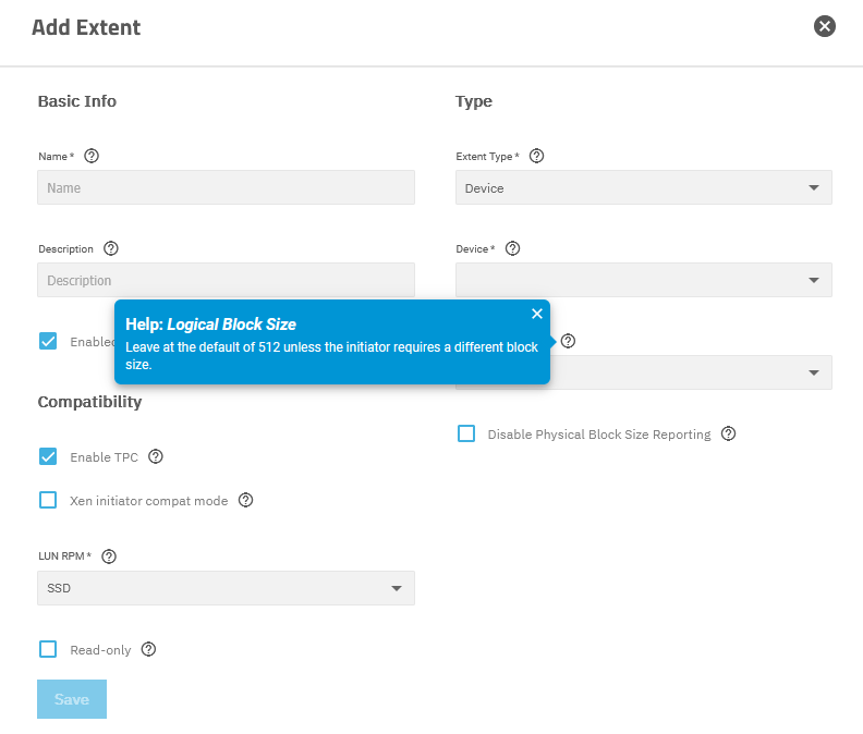

When attaching the iSCSI target, there is an option to set the block size to 4K instead of the default 512 bytes.

  5. Opened Extents → clicked Edit → changed the block size to 4096.

Well, in defense of TrueNAS, there are four block size options available in order:
obraz
However, TrueNAS does know the correct block size for a cloned ZVOL based on original ZVOL, and that information should be applied automatically in the wizard to CLONED iSCSI extents…
