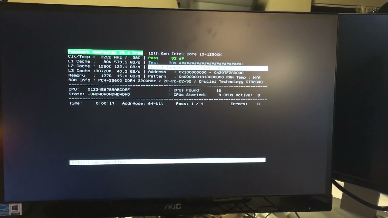

So now I am running memtest86 and sure enough, I’m currently at around 25 minutes into the test (pass 1, test 6) and it has already recorded over 700 errors.

(Again, I am starting to memtest first and so far, it’s about 10 hours and 50 minutes in, pass 3 of 4, running test 4, and it’s encountered 8043 errors so far.
I would think that if it was the memory that was the issue, if the RAM had THIS many error (and memtest isn’t even finished yet), I would have started seeing/noticing corruption issues a lot sooner, but I had always pegged the “bad page frame number” as being an incompatibility between the older Linux kernel with the 12900K and not necessarily an actual problem with the hardware like the current testing is showing.

For those that have been following this saga, I actually pulled the memory that was in my 5950X system (also four sticks of Crucial 32 GB DDR4-3200 unbuffered, non-ECC RAM, which passed memtest86 on said 5950X system before I pulled it).
This happened:
There is definitely something wrong with the CPU and/or the motherboard in order to produce this result.

(Like there is no reason why a system should be spontaneously rebooting itself when I’m trying to run memtest86 on the four sticks of DDR4-3200 unbuffered, non-ECC RAM from my 5950X system. (Which, I ran memtest86 on said 5950X system to make sure that there weren’t any problems with that RAM in the first place, and it passed on my 5950X) before popping them into my 12900K system and then that’s when I recorded the video of the system spontaneously rebooting itself whilst trying to run memtest86 on those four sticks of RAM.)
There is CLEARLY a problem here.

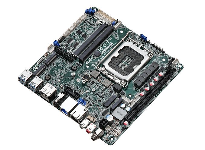

This isn’t necessarily helpful, but just a short heads up that the 12900k can support ECC if you have the W680 chipset.
If you look on the Ark page the 12900k supports ecc:
Tempted to upgrade/consolidate my desktop and server at home once I can get hold of a w680 motherboard, they don’t seem to be out there yet.
