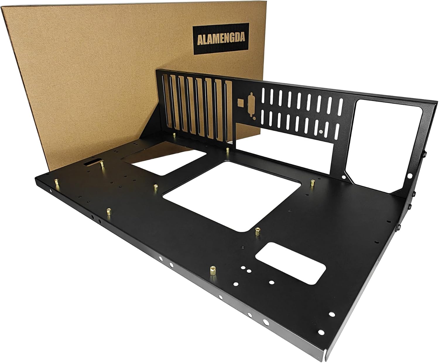

Stain it and seal it to help prevent warping as it heats and dries. If you’re not into woodworking I wouldn’t recommend this as diy, you could end up with something less than ideal. As for the donor case you could use something like this:
I like these guys when dealing with ATX and mATX cases. Also, sliger Cerberus is an option.

If you have an old case on hand that you don’t need, that would work.
For I/O ports, I mostly used XLR-style ports, mostly by CLIFF.
For “user facing” I/O in the MK ii I bought something like this and threw the pci-bracket in the bin:
For my DIY-Case I used a Dimas Tech micro-ATX-tray.
